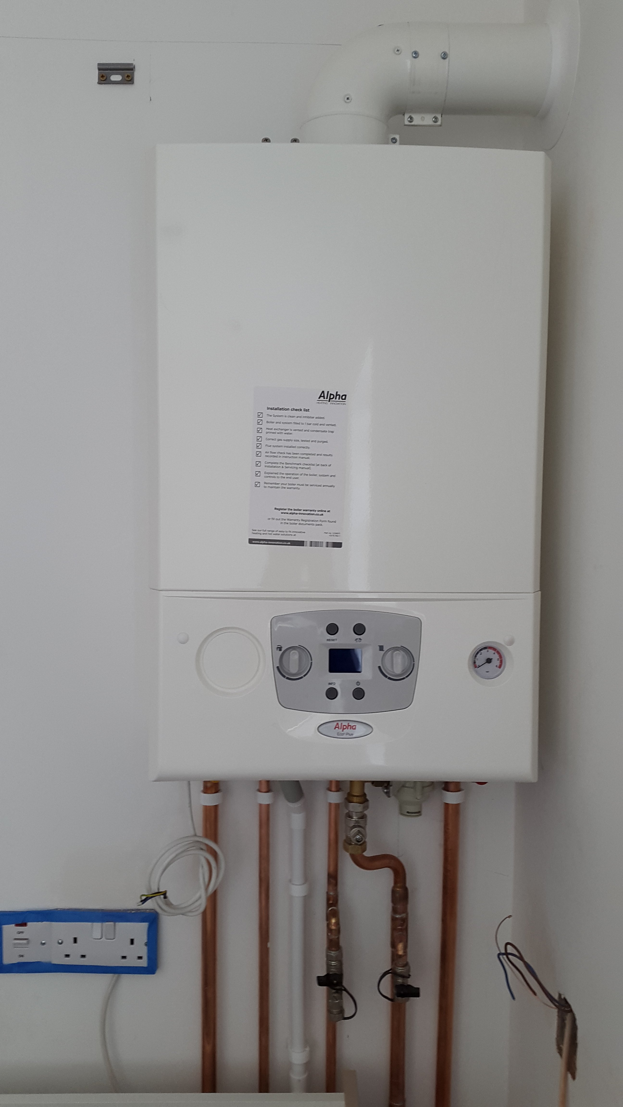

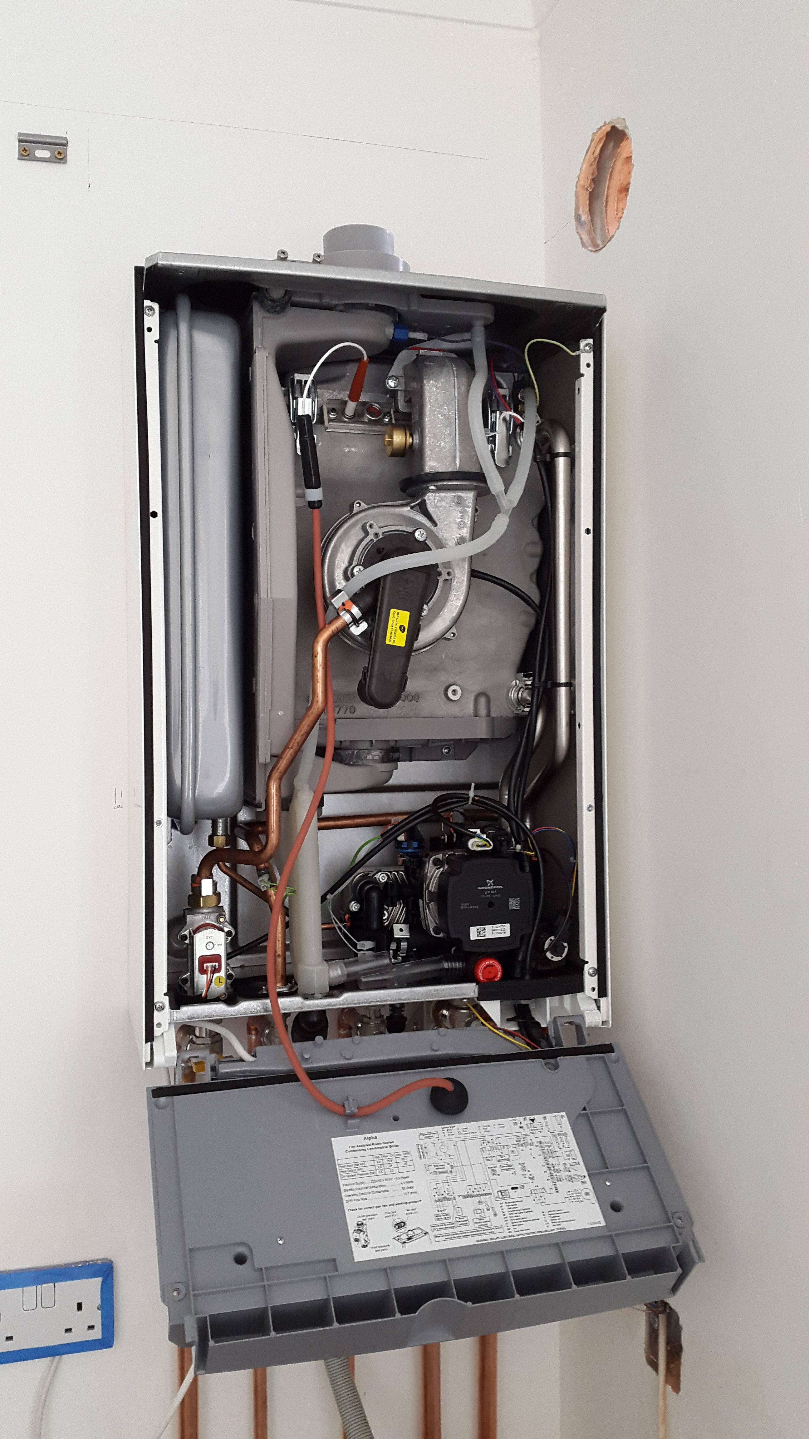

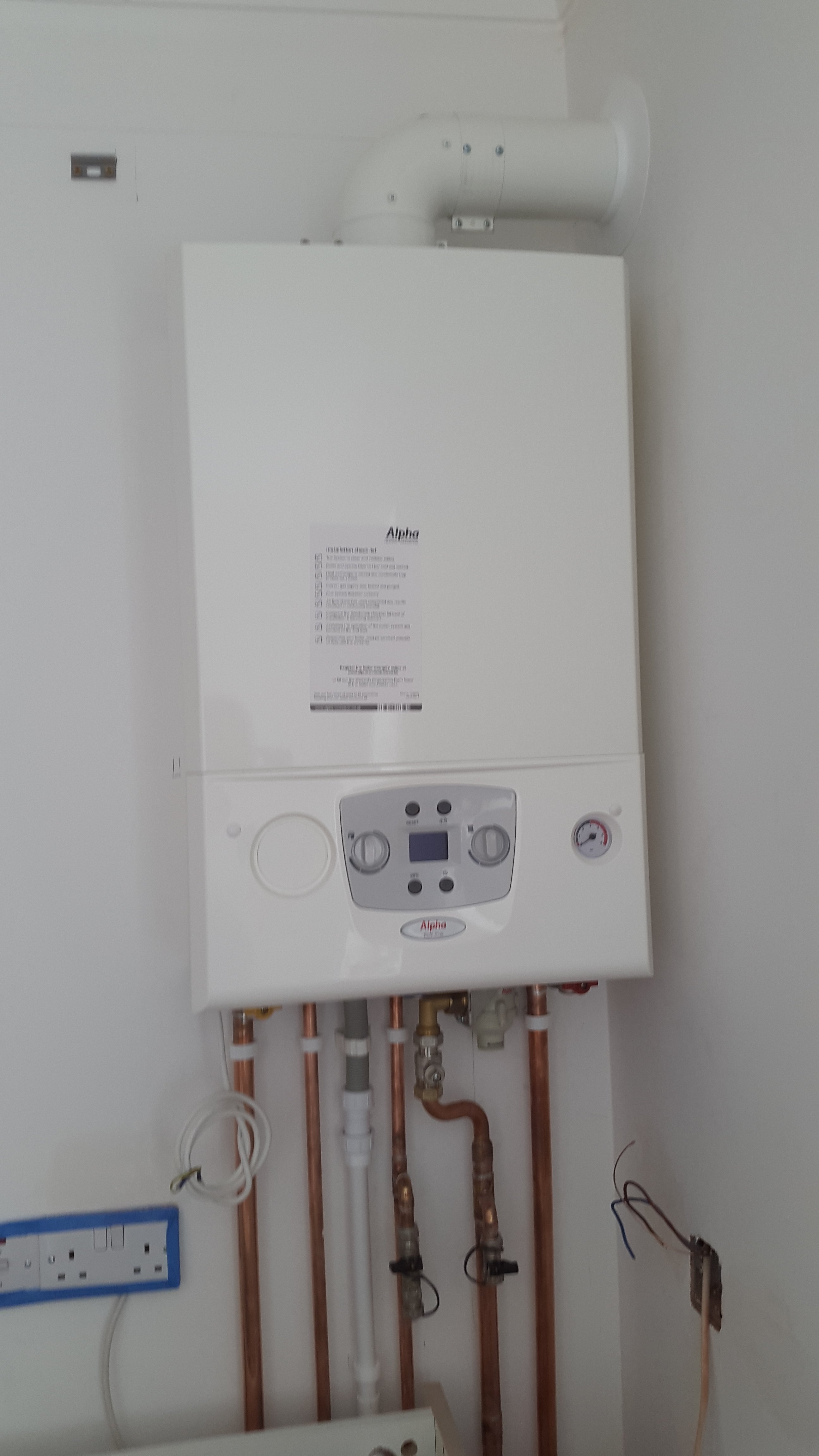

Here you go guys not wired as yet alpha eco 2 28kw not the best but certainly not the worst cheers kop

Fyi your condense connection will leak
Mac overflow compression coupling
Also read up on how to get them in low and high fire modes :D
Going on a factory vist on the 9th of may so will pick up a few tips then wasnt to keen on the condense arrangement 25mm to 19 mm reducer out of a rubber 45 0 elbow they supply , but it had a proper metal flue and elbow and all went in ok cheers chaps kop

Replaced the one I repaired with a viessman condense hose one jub clip either end and your golden
Did you put the included zip tie on the rubber to trap connection?
Love the bends
