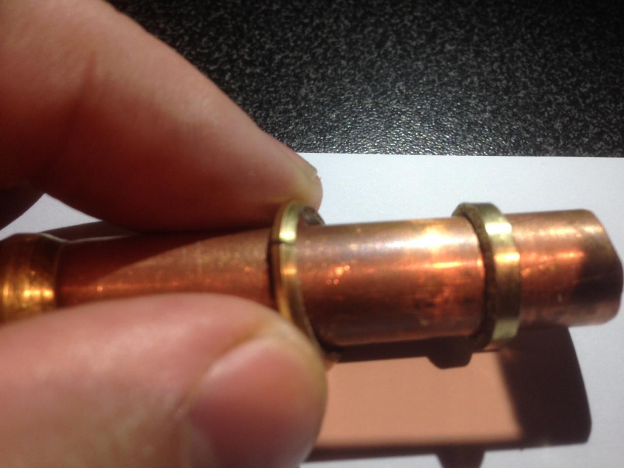

You discard the olive that comes with the fitting and only use the reducer yes
i hate those one piece ones they seem to fracture on the angle these are better [DLMURL="http://www.tradeonlyplumbing.co.uk/pipe-fittings/copper-pipe-fittings/brass-compression-fittings/compression-reducing-fittings/comp-15mm-x-8mm-reducing-set.html"]Comp 15mm X 8mm Reducing Set - Compression Reducing Fittings - Brass Compression Fittings - Copper Pipe & Fittings - Pipe & Fittings | Trade Only Plumbing & Heating Supplies[/DLMURL]
sorry wrong size [DLMURL="http://www.tradeonlyplumbing.co.uk/pipe-fittings/copper-pipe-fittings/brass-compression-fittings/compression-reducing-fittings/comp-22mm-x-15mm-reducing-set.html"]Comp 22mm X 15mm Reducing Set - Compression Reducing Fittings - Brass Compression Fittings - Copper Pipe & Fittings - Pipe & Fittings | Trade Only Plumbing & Heating Supplies[/DLMURL]
I prefer this type also
Out of the two options, I prefer the olive type, but they're both nasty in my opinion.
If possible I'll use a reducing coupler and go into the compression fitting with the size of pipe that was intended for it.
Got put off these when one sheared, split and leaked everywhere.
NB. Wasnt supplied by Williams
The problem for me with them is when I open the pack up with my clumsy hands all the bits scatter off in every direction so I spend 10 minutes looking for them.
Plenty of jet lube on em, I usually put them in a 22 ballofix when I'm reducing down
