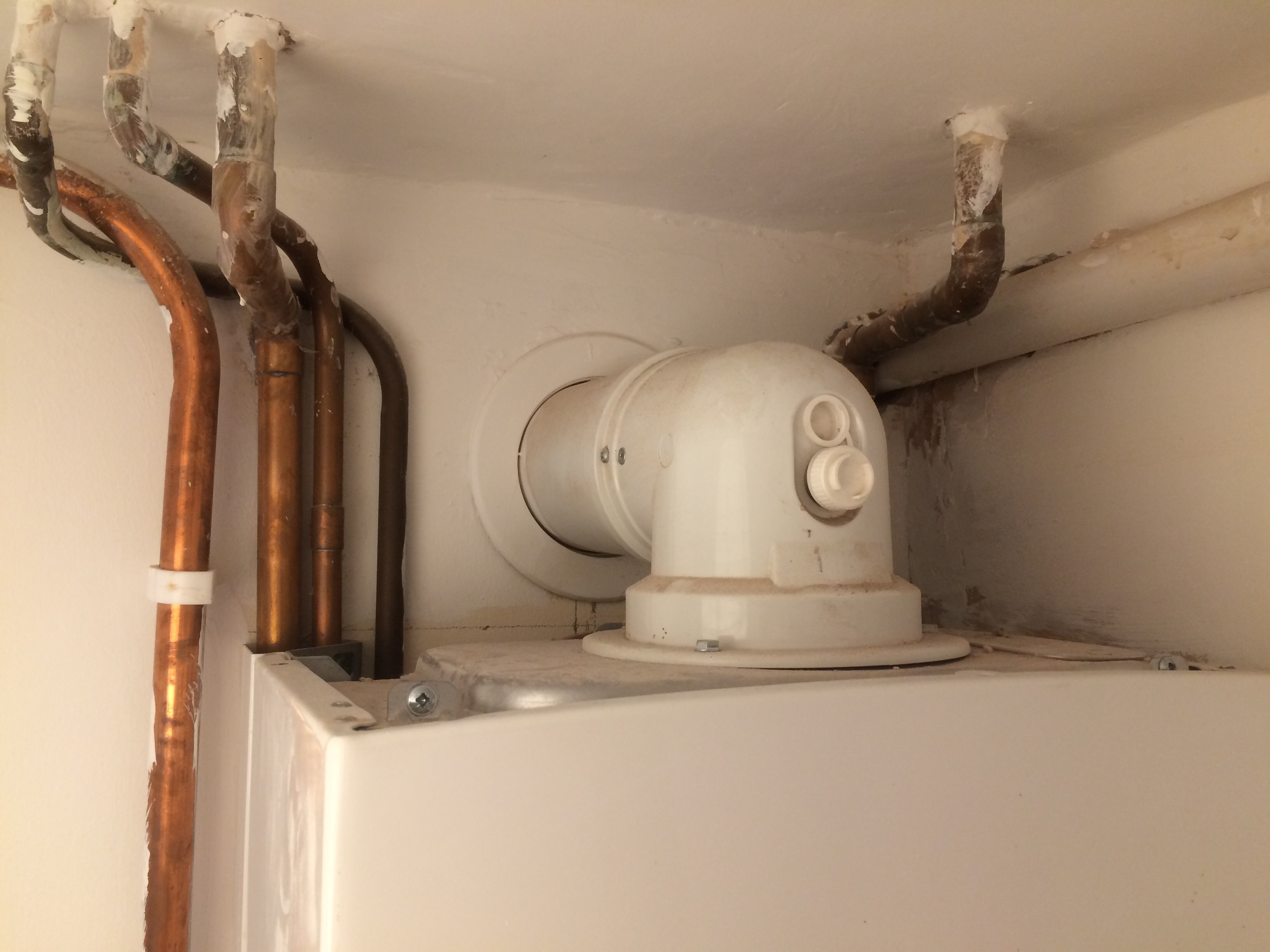

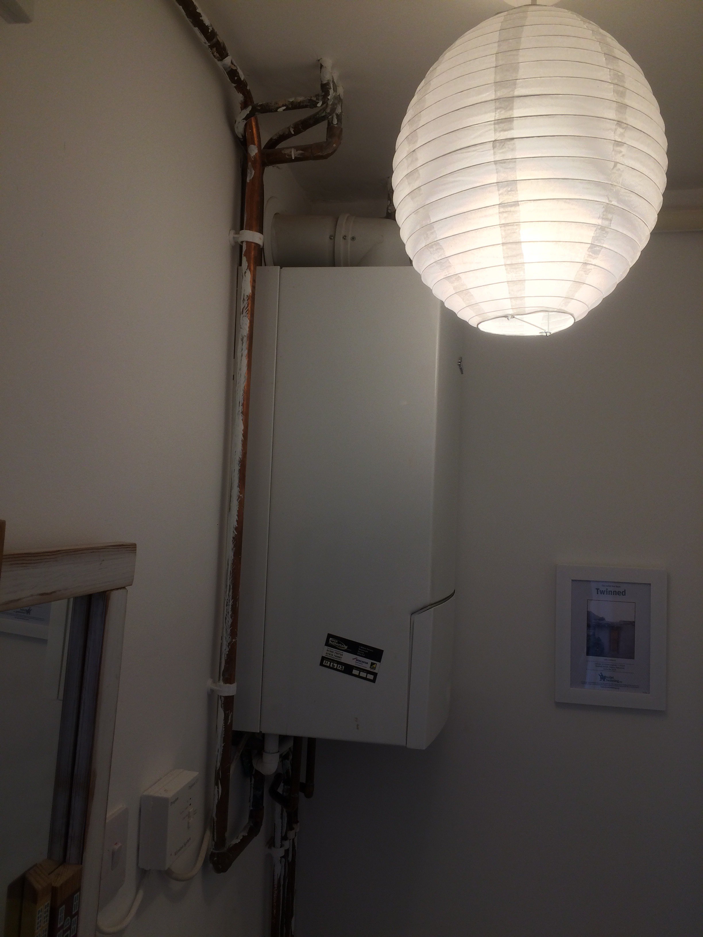

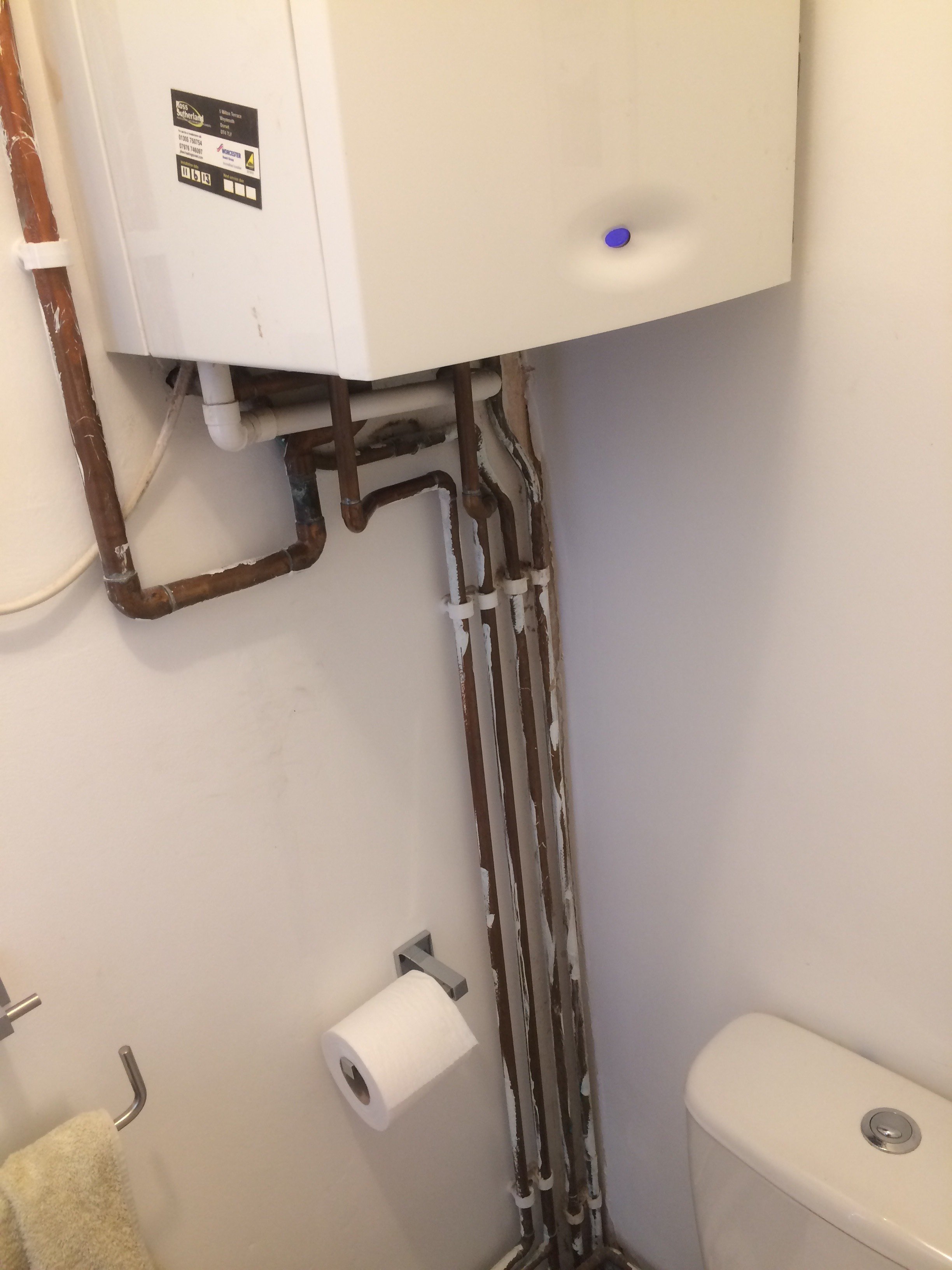

My customer would like a magnetic filter fitted. There's not a lot of pipe space - pics attached.
I've figured my two options would be an Adey Atom on the 22mm flow above the boiler (obviously not ideal, but I don't much fancy trying to access the 22return), or a very easy install on the 15mm return underneath the boiler.
What would you all do?

Where do the 15mm go / what do they heat ?

My answer to your question though. Would’ve to extend the pipes from the ceiling to for the filter. Or fit a Spyro
Downstairs radiators. Not sure how many, until I return to have a closer look.
Could you cut that lower (the 15mm) and bring the 22mm further down and loop it back up with a filter ?
If you get the original manga clean you can fit it on the return above the boiler and remove the solder elbow, the first magnackeans have more fitting options

Then u won't be able to open it as I looked at pics ,it is tight , is the 15mm below going to rads

Yes, the 15mm pipes below go to rads. So the filter would serve part of the heating circuit - but possibly only the smaller circuit. But better a filter there than none at all.

Have you had a look at the Altecnic/ Caleffi Dirtmag Mini, it is small and also has the option to install as straight through or as an angled valve.

It is quite acceptable to fit a filter away from the boiler as long as its on the heating circuit. You may have a more suitable spot if you look around....things are a bit tight around the boiler. centralheatking
