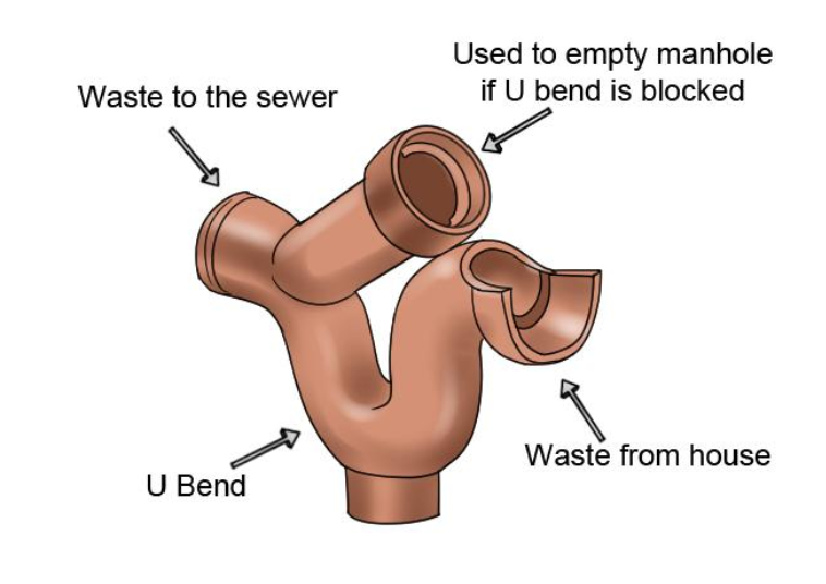

Has anyone mentioned an Interceptor on the outlet to the front
manhole?
manhole?
https:///www.labc.co.uk/news/my-dad-told-me-about-them-drain-interceptors

Yes, should ave mentioned that we have an interceptor trap at the front of the house
Any suggestions welcome.
Yes, get rid of the trap.
Unfortunately not a cheap or easy job.
There's no need for them in todays vented systems.
In a system with poor flow due to inadequate fall on the pipework the trap will allow grease to settle in the trap and eventually block.
The alternative that I used to do in one of my previous houses and my Son used to do in a house he owned later was to tip 1/2 a dustbin full of water down the manhole regularly to move solids from the trap.
