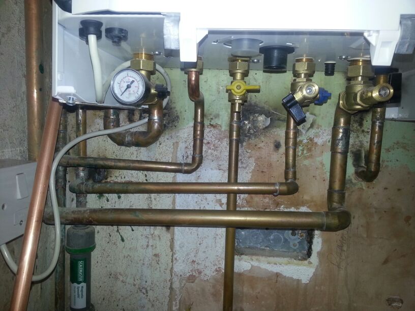

Hi All,
Turns out that while I was at work on Friday our engineer fitted an Ideal + 30KW not the Ideal Vogue 40KW as agreed so he is back tomorrow to fit the new one (as long as it's in stock) and take out the old one!! :(
Just wanted to share some photos of the work done thus far ..... We're getting a new kitchen so had everything stripped, a sparky came an put in some new electrics, the floor has been leveled and new pipework put in place. We're having spotlights in the kitchen too so the old wooden ceiling was taken down and we came across some damagaed ceiling! That's been removed as it appears the previous owner had a leak!

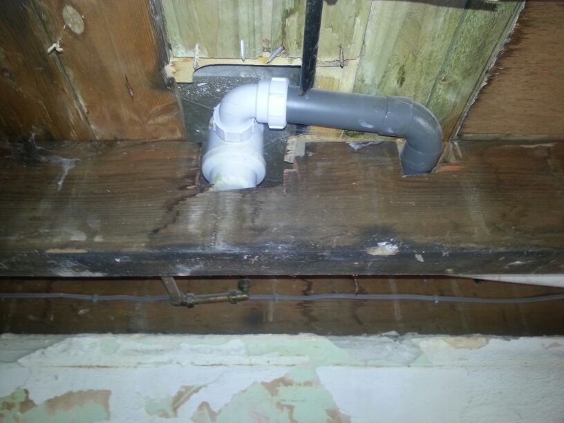

Its given me a chance to see the pipework for the bathroom as well as a MAJOR error by the previous occupant - he has cut into the main joist for the shower (See pic below) -the guys we have are going to properly support that but it's not good!

new boiler pipework
top of boiler

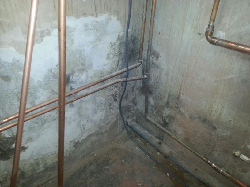

corner below boiler (does this look like it needs a proper reskim?)

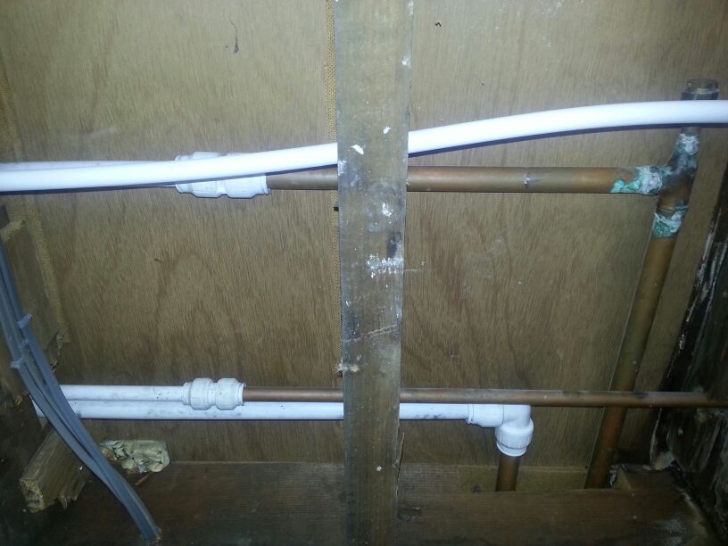

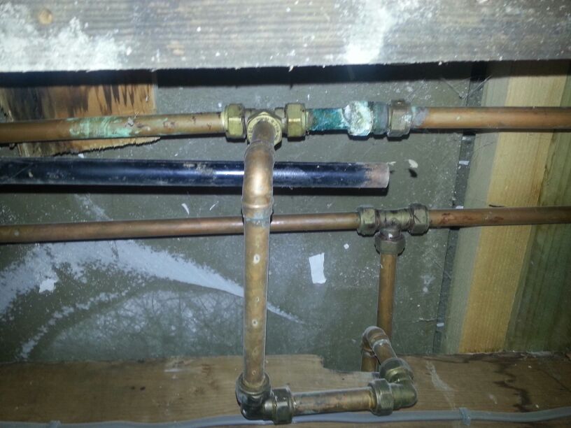

old pipework with new pipework (are these new fittings okay?)
The problem! The joist has been cut ... and its more than it should be !!
Some pipework looking up at the ceiling - should I take the opportunity to change this now ... OR when the bathroom is done? Doesn't look great!

On another note, how big is the gas pipe?
It needs to be at least 28mm or 1 inch at the meter, and nearly all the way to the boiler for a 40kw output.
There's no point having a 40kw if there's not enough gas at the boiler.
In the pictures it's only 15mm! Which is ok for the last few feet.

My baby boy could do neater pipework, did he have no clips????awful
Well to be honest its someone who works with him that did the pipe work. There are clips - just not around the boiler ... I'll bring that up when I see them tomorrow ...

Your fitter is rough! The flue retaing clip isn't on correctly! The black stud in the Center should project through the Center of the white horse shoe! If you can dislodge the horseshoe easily with your hand you are should switch off the appliance and wait for your fitter to fix it.
Is behind the white rubber against the wall filled with cement or plaster?

Its plaster then brick work! You were right about the flue retaining clip - it was on, but could easily be removed. I've noticed that it's not straight !!!
Well ... I've already agreed the Vogue ... so fingers crossed its okay .... these hardware updates .... do they have to be done by a qualified fitter, or is that something I can do?
There appears to be a check valve only on the ch return filling loop point. Not complying with water regs
Just to say that they have't finished commissioning the boiler anyway so perhaps this was to be added later? Can you be more specific where this valve should be as I guess they should add one for the new boiler? I'm a novice after all!
Thanks!
Check valve is built into the filling loop assembly as supplied by ideal and meets all water regs.
Vogue updates either done in factory or by ideal once registered. Free of charge!
Get Flue clip sorted and turn boiler off until its safe!
It's illegal to leave un commissioned gas appliance connected to gas supply!
