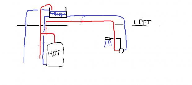

Im going to keep cold feed from CWS in loft in 22mm to shower in the main bathroom, but my question is I want to tee off the hot water cylinder as close as I can to the bend coming out the top, run that up the wall into the loft in 22mm, tight against the top of the joists, run in about 2 meters across the joists and back down into bathroom where shower will be. The CWS tank is about a foot off the ground in the loft and its a 50 gallon tank.
So then in the future when they want a pump i can just configure pipework in the airing cupboard, instead of re routing a lot of pipes.
Do you think the pressure will be ok not great obviously? or is this too close to a negative head? Meaning they will need a negative shower pump in the future?
Ive added a diagram i drew up on the pc to give u an idea, now please bare with me I know its terrible but just thought it would be good if you could see it (or not lol)

with a low pressure shower valve you will get water through but your looking at about .5psi and the lowest shower i know of is .1 i would fit a Stuart turner neg head 3bar whole house pump on the hot. the tanks big enough and it would seem a shame to fit all this then someone runs the tap downstairs and you loose your hot supply to shower
another option would be to fit a power shower utilising hot and cold gravity feeds
They will get a low pressure shower valve, when the pump is fitted do you think this will this effect it at all?
At the moment the ensuit shower has really poor flow, so in the future they will get me to fit a pump and deal with the rubbish pressure atm.
But my real question is with the hot and cold pipework being taken into the loft after the shower pump and back down to the shower, is this a negative pump or a positive pump? In theory it should be a positive pump as the outlet of the shower and all pipework isnt above the CWS tank right?
Just want to make sure im right is all before going ahead with it. Because after i fit this bathroom the ensuite shower needs doing and i was thinking of just teeing of hot and cold in the loft in 22mm and running to other shower, then they will both be pumped with the correct sized pump.
Again any info would be great, cheers
Most shower pumps require 2 metres head of water. Provided the bottom of the CWS tank is 2 metres above the shower head then you want a shouldn't need a negative head pump. I have done the same as you many times to run 2 showers from the one pump and used a 2 bar stuart turner.
I spoke to stuart turner a couple of years ago to ask if it was possible to put their pumps in the loft and tee into the expansion pipe for the hot supply. They said it would work fine provided the tee was below the bottom of CWS tank as the head of water required is from CWS tank to shower head not the pump. I've done it loads of times now and never had a problem.
