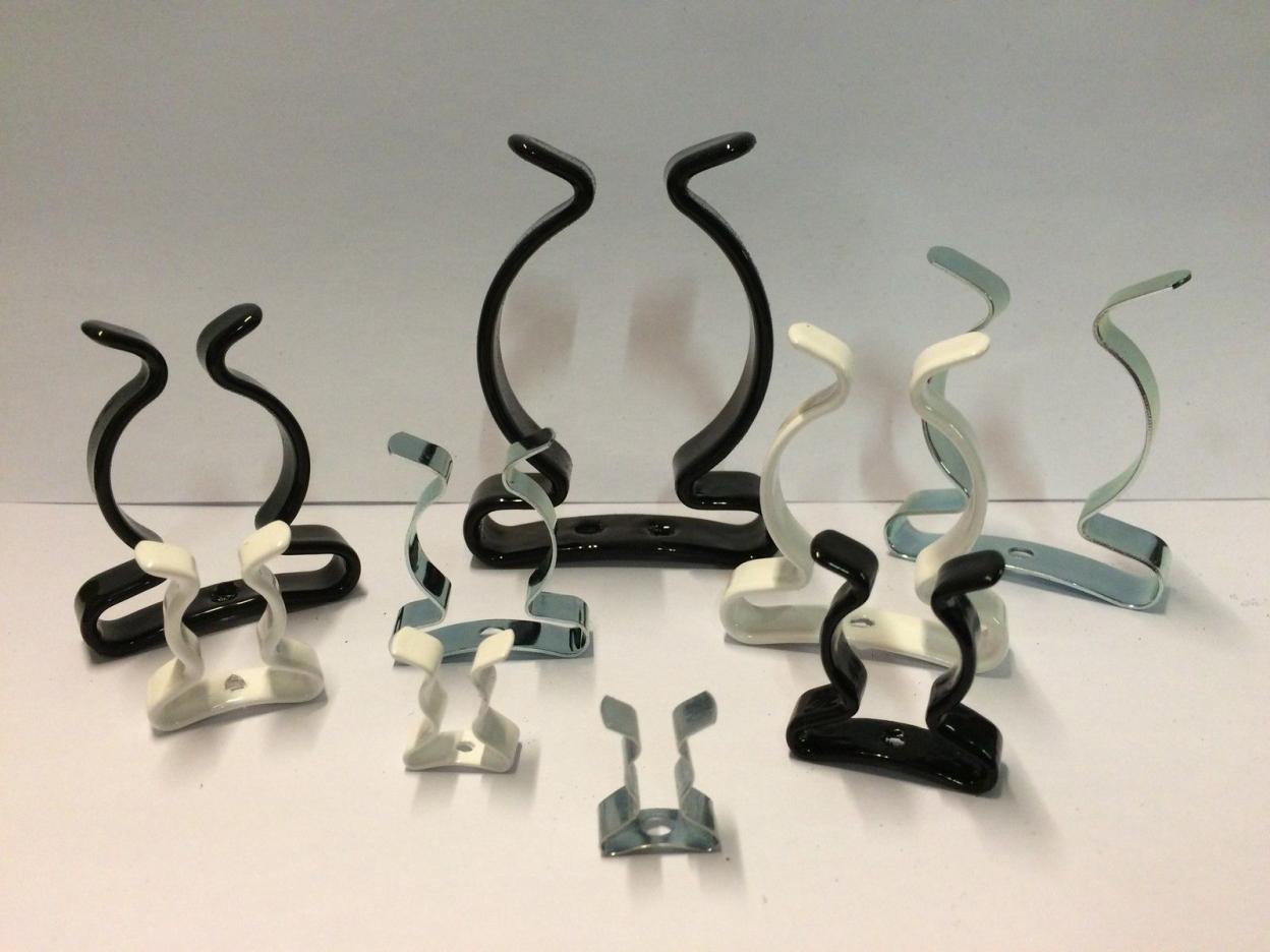

Don't use plastic ties go brittle and break
Hot loads every 2 foot max
Thanks i would have used plastic ties so you can get metal then? Where from.
Regards.
Either punch banding or metal (duct) jubilees
Screwfix should have something
