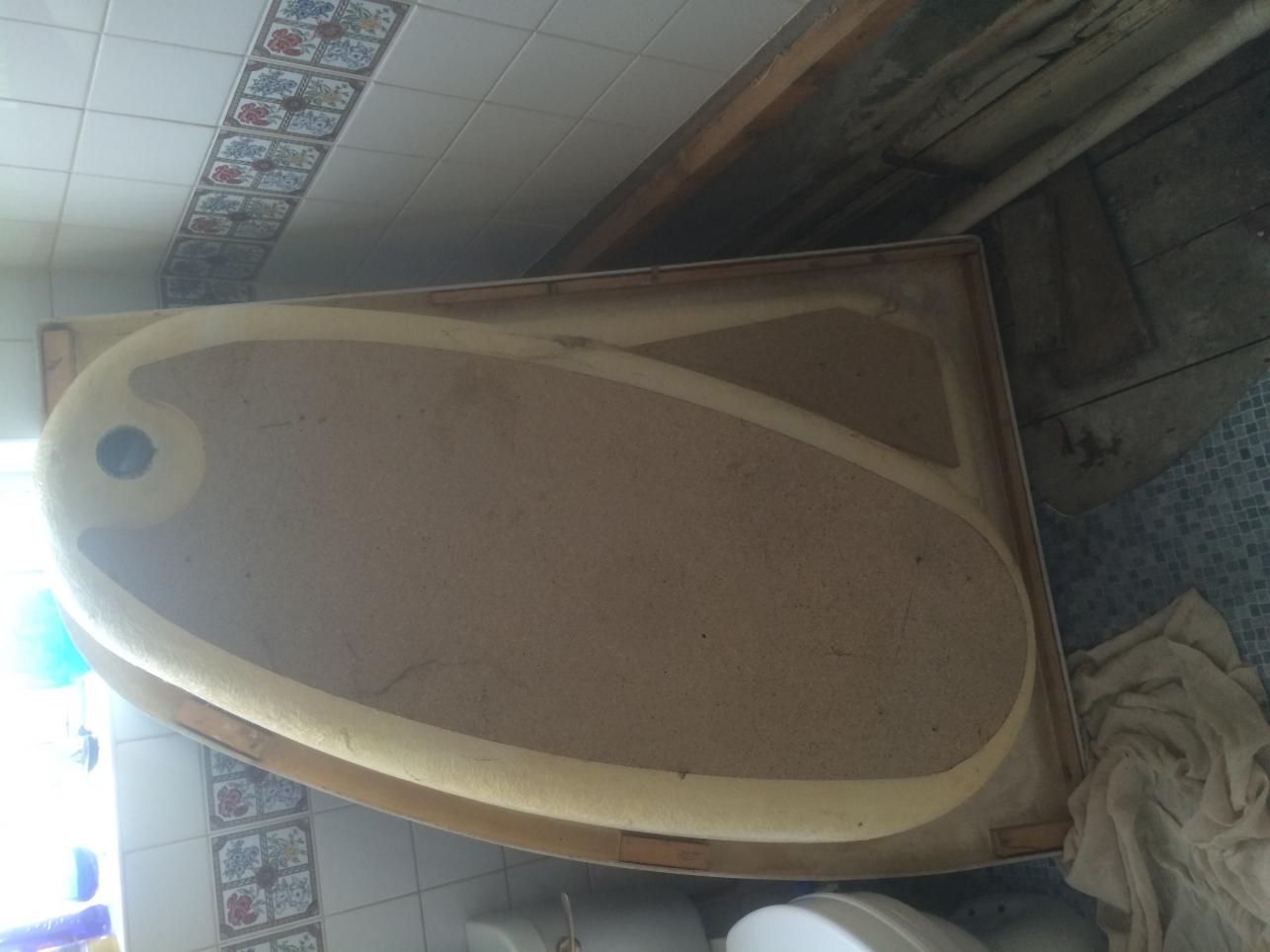

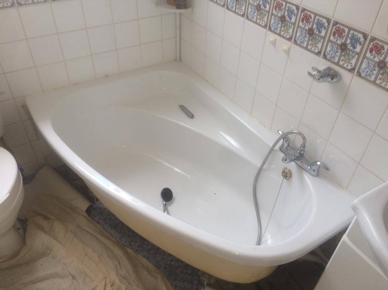

I just quoted for a job to replace a corner bath for a straight 1500mm bath. I worked there before doing a vanity unit and new wc and other bits. At the time I said you may as well change your bath etc. money was tight so they never went through with it. However in the mean time they've ordered a new bath and called me to fit it. No problem I said so went round and discovered they've had new vinyl flooring done and I've also got a feeling that they would like the tiling un damaged. Am I walking into a nightmare as its quit tight for room? I've done hundreds of baths but always retiled etc. I've never tried to take one out in this situation. I'm thinking cut it into 4 once disconnected and loose with an angle grinder and carefully remove it in pieces. I don't mind replacing the bottom row of tiles if I have to as they are small 5 inch squares. However the floor is worrying me a bit. I have some ply in the van I could cover it with with dust sheets under it?

I will notify them before I start that things like tiles may become damaged. I'm pretty confident I can protect the floor with thin fibreboard and sheets. It's removing the bloody thing in one piece im concerned with. I'm going to cut it into pieces with a grinder to reduce the size. If I have to retile it then so be it. I have about four or five packs of white tiles in my van for a splash back.

image.jpgUpdate!

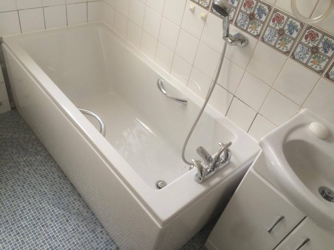

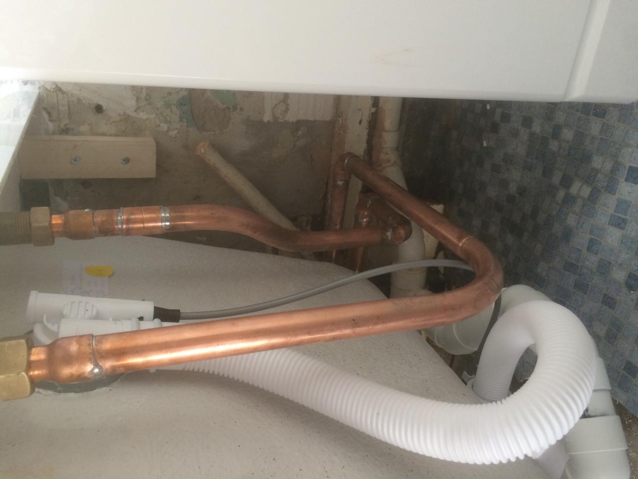

any reason for using all them 45 on the waste?
Yes mate. I never had any 90 elbows in the van. :wink_smile:
? did you have to get round something? and never use 2 90s on a bath block too easy
