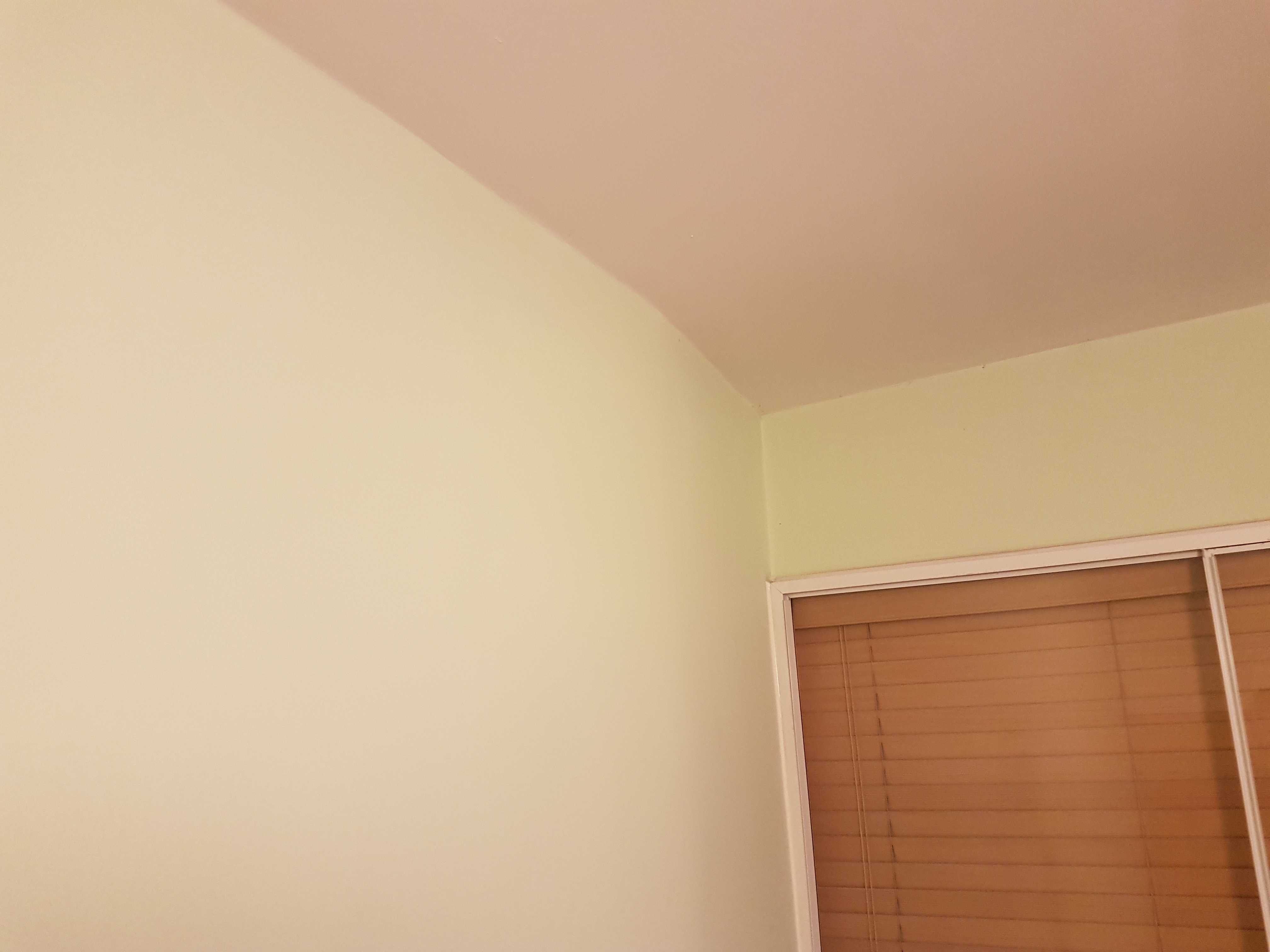

Not plumbing but, in a building over 100 years old recently. And the wall runs along straight then suddenly bends by about 3 inches so as not to hit the windows. There's always been the careful and the careless in all trades. New builds are often very poor but quality has always been variable. My 2p. ;)

Is that a partition wall in a terraced property?
Hmm. Are you sure that the original wall hasn't been modified by someone adding internal insulation much more recently than 100 years ago? They'd have stopped short and then curved out to avoid the window.
No, it's in a block of flats built for slum clearance in 1900's and it's all on' the cheap (and on the p!) None of the rooms are really square , floor levels are out also. I'm a bit of a geek for how buildings are built and how they work. I have got other pics of that wall on my other laptop when we were refurbishing. I think it was the setting out went wrong. It was a matter of cost to put it right so the corner was cut and it was left like that forever.
Nope. Pics from both sides coming soon if you like when I fire up old laptop.
