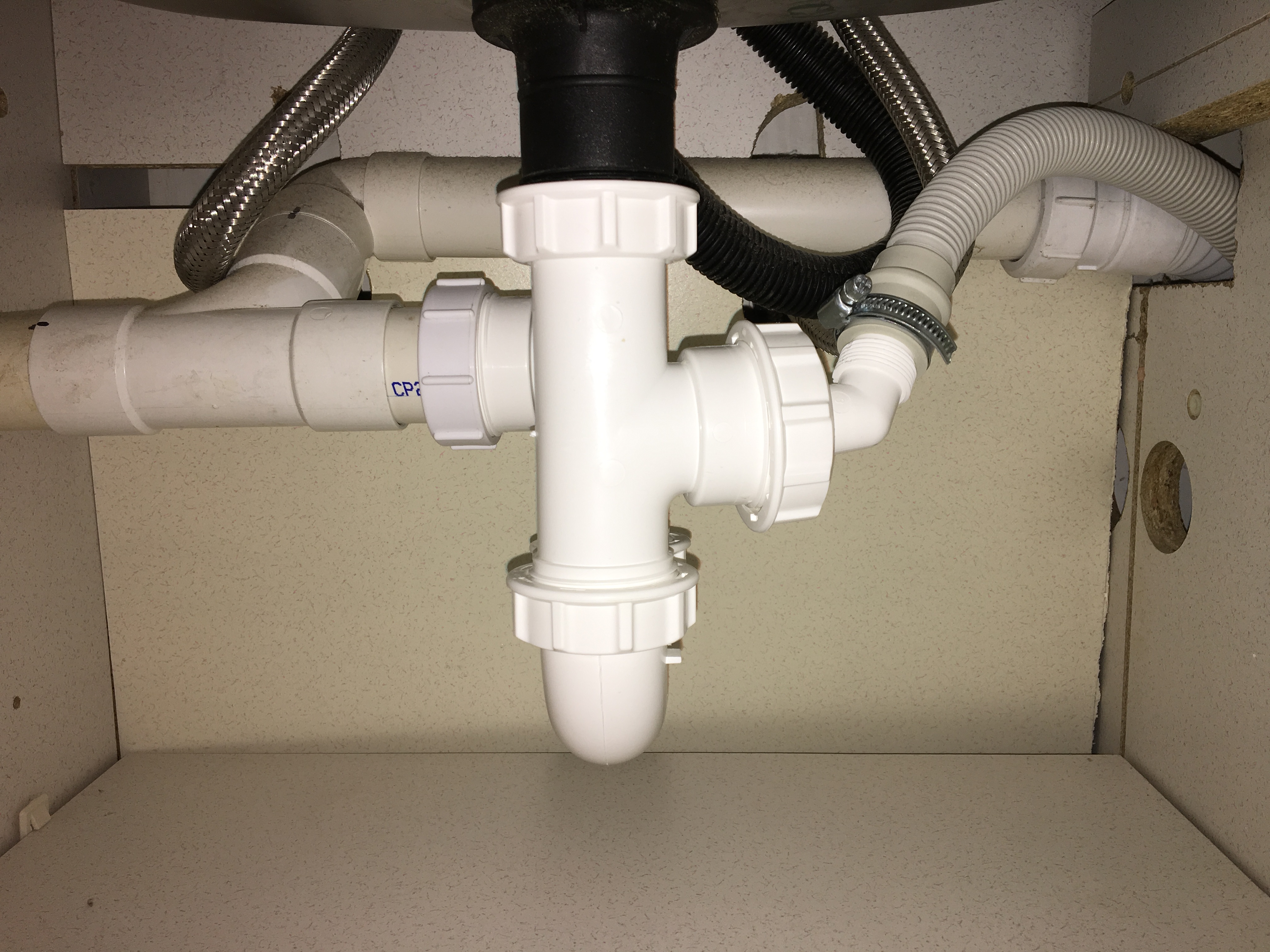

I feel like a right plonker and hoping for some help! I have a new Miele washing machine, it was plumbed into a standpipe but the standpipe was far too small (it's only around 12 cm long and is about halfway up washing machine), this is what the fitters told me. So I thought I would plumb it into a spigot below the sink with a jubilee clip and thought that would be straightforward, I bought the new sink trap with spigot from screwfix, atatched with jubilee clip and...it didn't seem to work at all, when I looked at it - the spigot appears to be below the trap exit if that makes sense - is that why it didn't work? It came like that from screwfix so maybe that's why. And then I tried to go back to how it was but it doesn't seem to drain as well as before - looking at the end of the waste pipe just inside there is a hard black bit of plastic which when you press down seems to increase the waste flow. Is this supposed to be there and have I damaged anything? Appreciate this probably doesn't make much sense but any help appreciated. All the best
Is your waste hose from washing machine running at high level under worktop before connecting to spigot on trap? Thats the prefered method of connection... As for the black rubber piece. That looks lile it ahouldnt belong there?

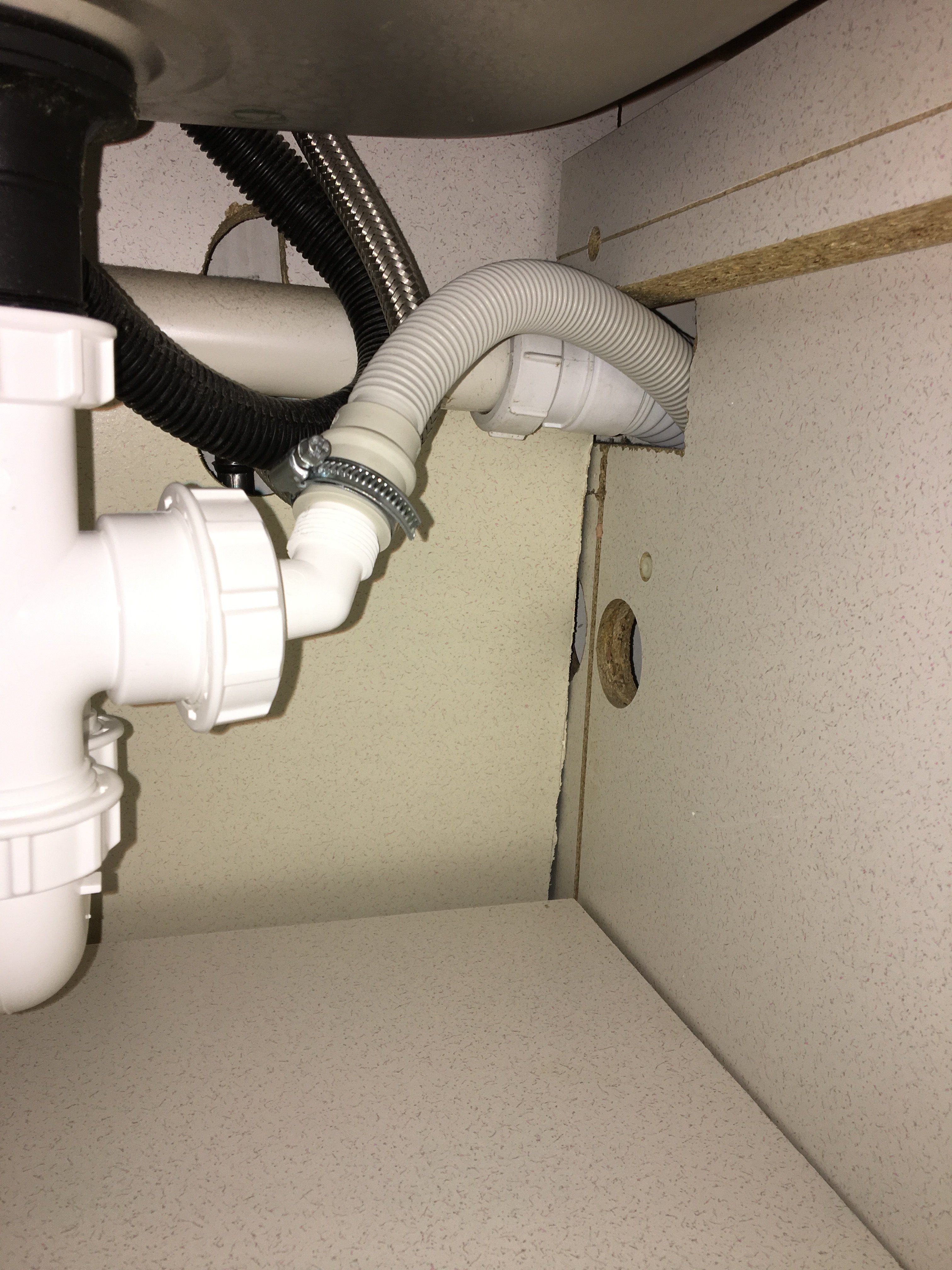

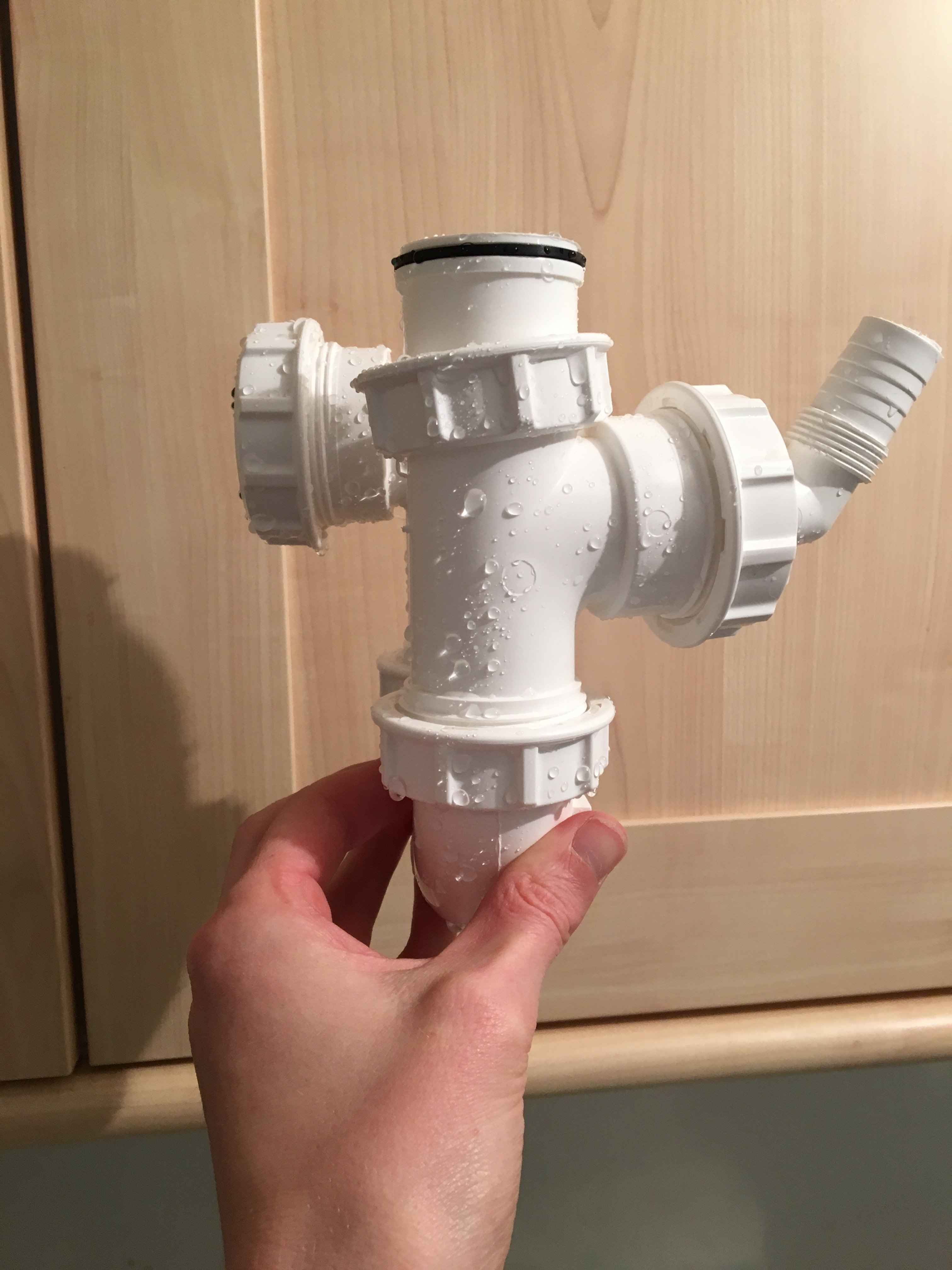

Hi, thanks for your help, the whole thing is driving me mad! :) I should have just got a professional in but I thought I could do it. Yep the waste line goes along the top of the machine and then down slightly into the trap in the sink next door to it. I'm just trying to decide whether the problem was the trap (see attached photo, hopefully you can see that the spigot is lower than the trap exit - would this mean water couldn't flow through?). I've taken the trap back off now which is why it isn't attached to anything. Just trying to decide if that black bit just inside the waste hose should be there or not? I tried ringing Miele but no technicians in on a Saturday. It definetely changes the flow when you press it. Don't want to mess with it if it should be there!
Never personally fitted a miele washing machine. Have you removed transit bars? Take it the machine spins and works just doesnt drain??
That trap is cheap but adequate. Some manufacturers have their spigots lower than the outlet and some dont. Dont understand what that black washer is doing in the waste house unless its a non return valve. Have you tried removing it?
Hi, thanks for your help, the whole thing is driving me mad! :) It definetely changes the flow when you press it. Don't want to mess with it if it should be there!
The trap will do the job besides it is easy to change at a later date should you wish to.
The spigot the hose fits on to isn`t blanked off is it?

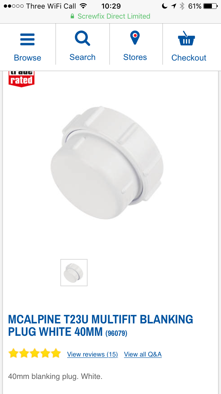

Believe that trap has a cap end on the spigot and not needing a hacksaw to cut it off. Maybe wrong tho!

I could go back to screwfix and take a look at one of those traps again and see if there are any caps that could have got lodged in the hose
It isn`t from the trap. Again tell us what you`re pressing and how do you know for certain it helps water escape faster.

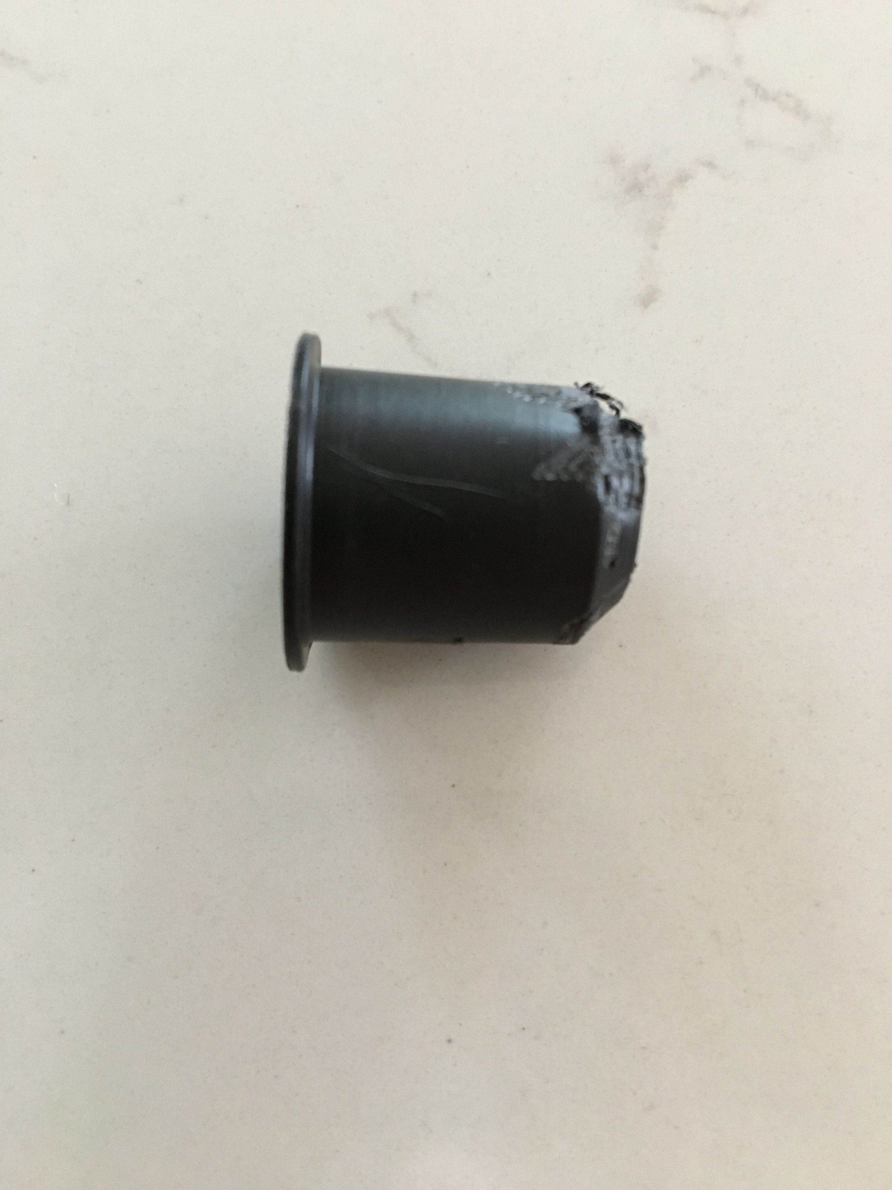

So when the waste hose is literally just placed in the sink basin the water flow out of the drain hose is pretty slow, when I put my finger up into the drain hose there is a black plastic piece which when you press it, the flow of water increases markedly

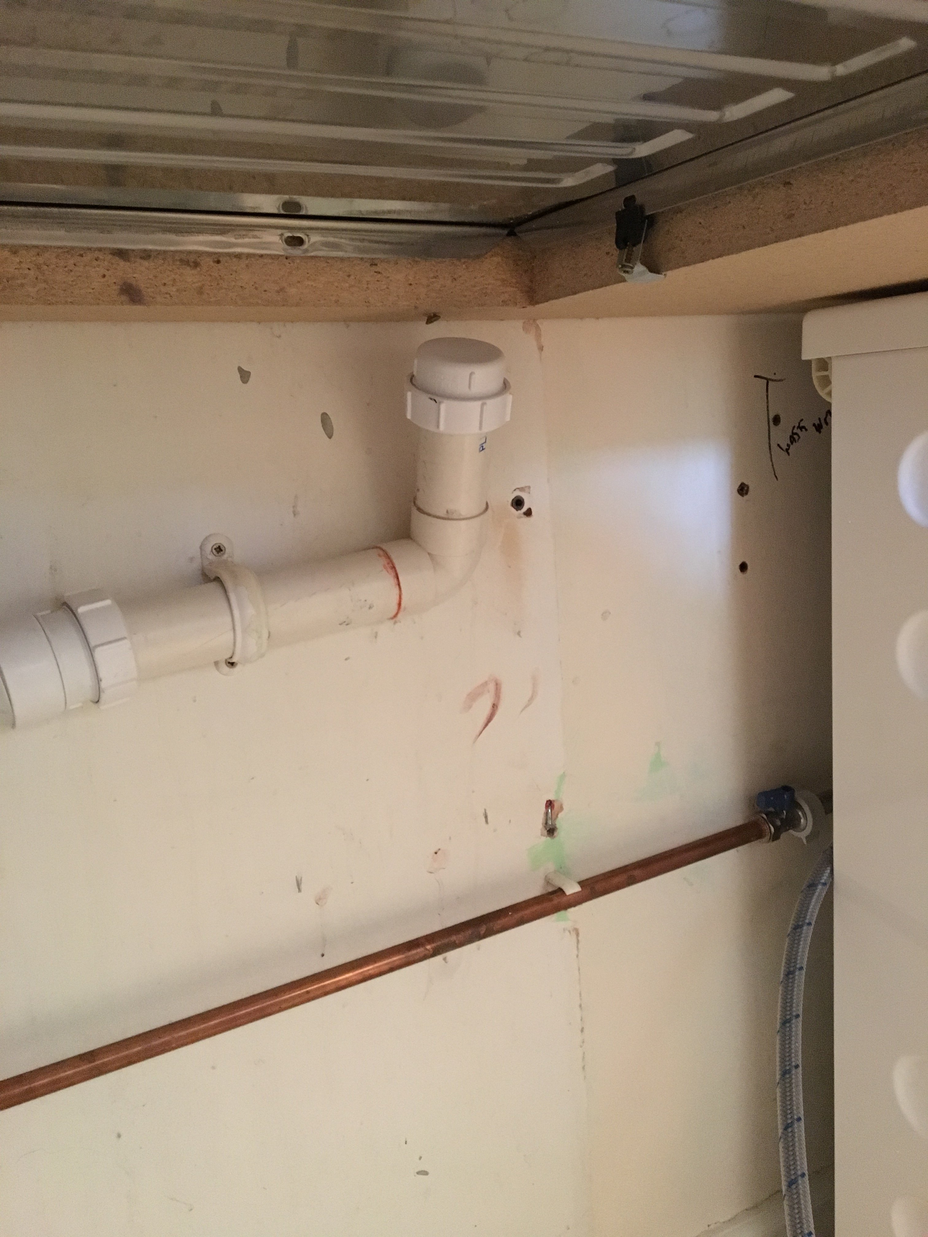

Just some images to show you why I started all this in the first place - is that a dodgy setup with such a small standpipe and also it goes beyond the trap so open to the sewers? It does smell a bit in the room occasionally. Any ways that's just an aside so you know why I wanted to try and make it a bit better than the previous owners.

Yeah white cap. Did you take a cap off the spigot originally?? If not its more than likely stuck in the hose where that black washer is...although ive never seen a spigot cap with a washer init before. As for the original standpipe.. bet it stinks in there
..best to cap off with solvent weld 40mm coupling and 40mm inspection eye.
A plastic bag taped around it will do for now.
I don't remember a cap on the spigot, i did saw the smaller bit off. Thanks for the tips on the standpipe, at least my reasons for starting this were valid!!

Why would somebody have done such a pants installation to start with in regards to the standpipe?! Drives me bonkers how people don't just do a job properly. I've already had to replace the wiring to he tumble dryer so I guess they just did things a bit dodgy!
I think the black item in the end of the Hose is a non return valve and it's being jammed in by the spigot on the trap.
Either don't push the hose on as far as you have been doing before tightening the clip or measure how far up the hose the vavle is and cut the waste spigot down to that length minus about 10mm. (so there's a gap between the end of the spigot and the valve)
Thought that earlier but then it shouldn`t be able to be pushed down the hose so scrapped that idea.
UNLESS, the valve flap has been forced back passed the seat when the OP first fitted it to the spigot, If so a very small screwdriver and try and get the valve flap back out so it opens outwards again :eek:

OP: You were right to meddle as your original standpipe is wrong in many ways. By all means cap it off.

Thanks for all the replies, I really appreciate it. And nice to know it wasn't acceptable as it was, as I've been wishing I hadn't started, so at least it's been worth doing. I've read the manual a few times and to me it's just not super clear, it would be great to get Mieles opinion or somebody who's seen a similar hose. But it's reassuring to hear that such a valve is unnecessary from what I've read. I'll have another mess with some pliers on said bit of plastic - from what I can see it's actually a fairly big bit of black plastic about an inch or so in length. It hardly moves. Once I get a bit of time I'll try putting the spigot trap back in and having a play to see if I can get it to work. All your advice really helpful thanks very much
By the way rpm I completely agree I am sure I have done something to said bit of plastic when I put it on the spigot, I did ram it on a few times before I decided to cut down the spigot to size. The moral of the story is don't start a job when knackered after the kids in bed!!! :)
  • Agree
Reactions: rpm
Aaarrrgghhh it's driving me mad. I have the waste pipe just free in the sink, so no issues with spigots etc it's simply a waste pipe in a sink basin. Drains super slow, but if I press the black thing in (it moves around 3mm) I get full, super fast flow, let go and back to a trickle. The black bit is definitely a solid bit of plastic, maybe an inch or so with a tiny gap round the side. I've even tried to pull it out wth pliers but no joy. I think time to admit defeat and see if Miele can come up with anything on Monday or even send someone out as I can't see what I've done to make it do this. Thanks for all your help will sleep on it
