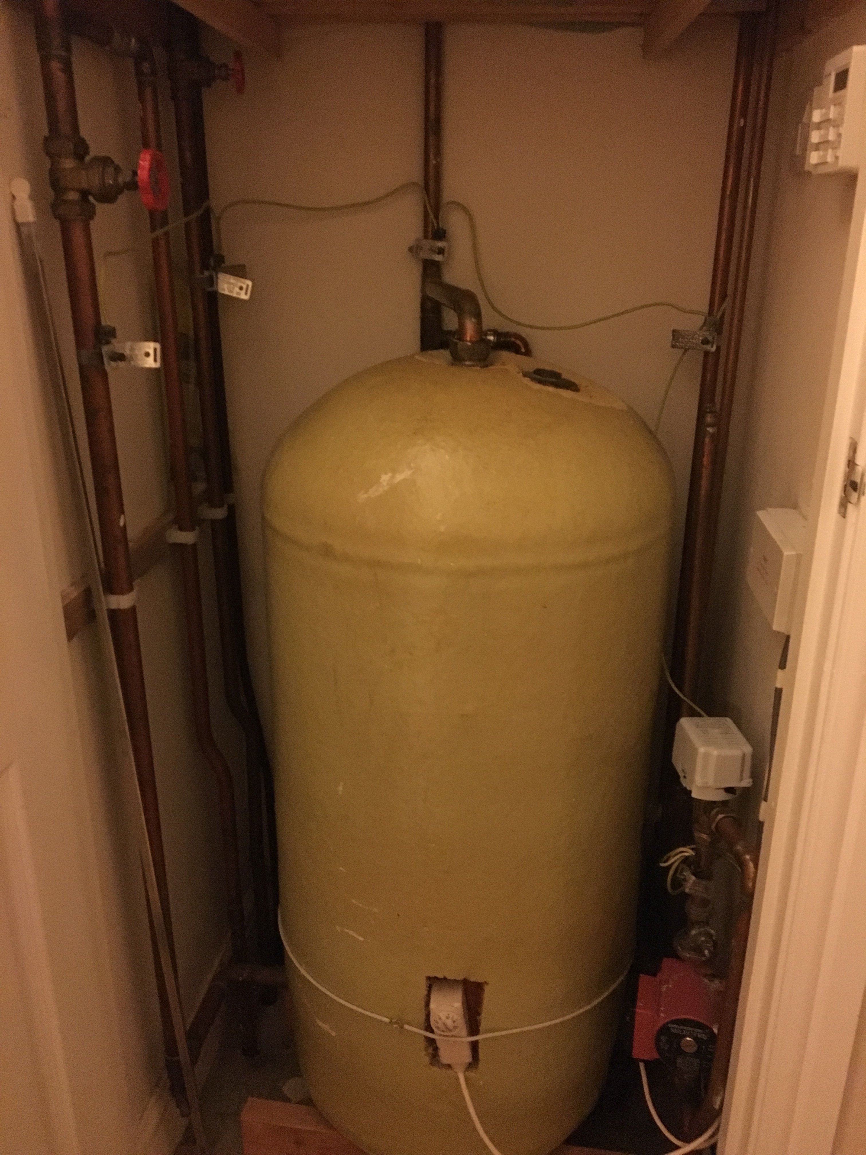

Do you know what sort of boiler and system you have, if not see if you can upload a picture of the boiler and a radiator or two with the surrounding pipework. It is either an issue with a failing pump or a dirty system or possibly both, the former is easy to check.
I think we all sympathise when you move into a place and you have a list of things as long as your arm that need sorting. Unfortunately it does sound a little like your system might well be mucky. As per post above pics of boiler and set up as well as an idea of pipe sizes leading to radiators would also help
We have a heat only boiler. I think I’ve posted some photos for you to see?
Ok so fairly small system I’d say potentially not a balancing problem. By turning off all the other rads except the not working ones can you get them to heat up
Agree with above, perhaps turn off all upstairs and see if downstairs heat up and then vica verca then continue to open one at a time and see if they can all heat up if not all simultaneously. Although debris can shift you're tying to establish whether it's the pump, crud in the system or both.
Is anyone competent enough there to crack open one of the radiator valves and see if the water is mucky
The plumber that came here said that the water in the heating system is very clean so no need to flush the system...but that was when he fixed the non working kitchen rad and before we had the problem with the two upstairs rads and now just the downstairs 2 rads
Find another plumber, make sure he tests the pump and all the TRV's before deciding to go ahead with a powerflush. A heavy duty cleaner (if that is the issue) should be able to get your system going without the need for a powerflush in my opinion.
i would change the pump as its lasted well, i would say its the same pump as when they put the system in
Small bore pipework will block very much easier than 15mm pipe. Clearing it is so difficult. A heavy dose of cleanser is required and also a Magenetic Filter to collect the deposits as they are loosened. Clearly a flush is needed. That damned microbore again!!
