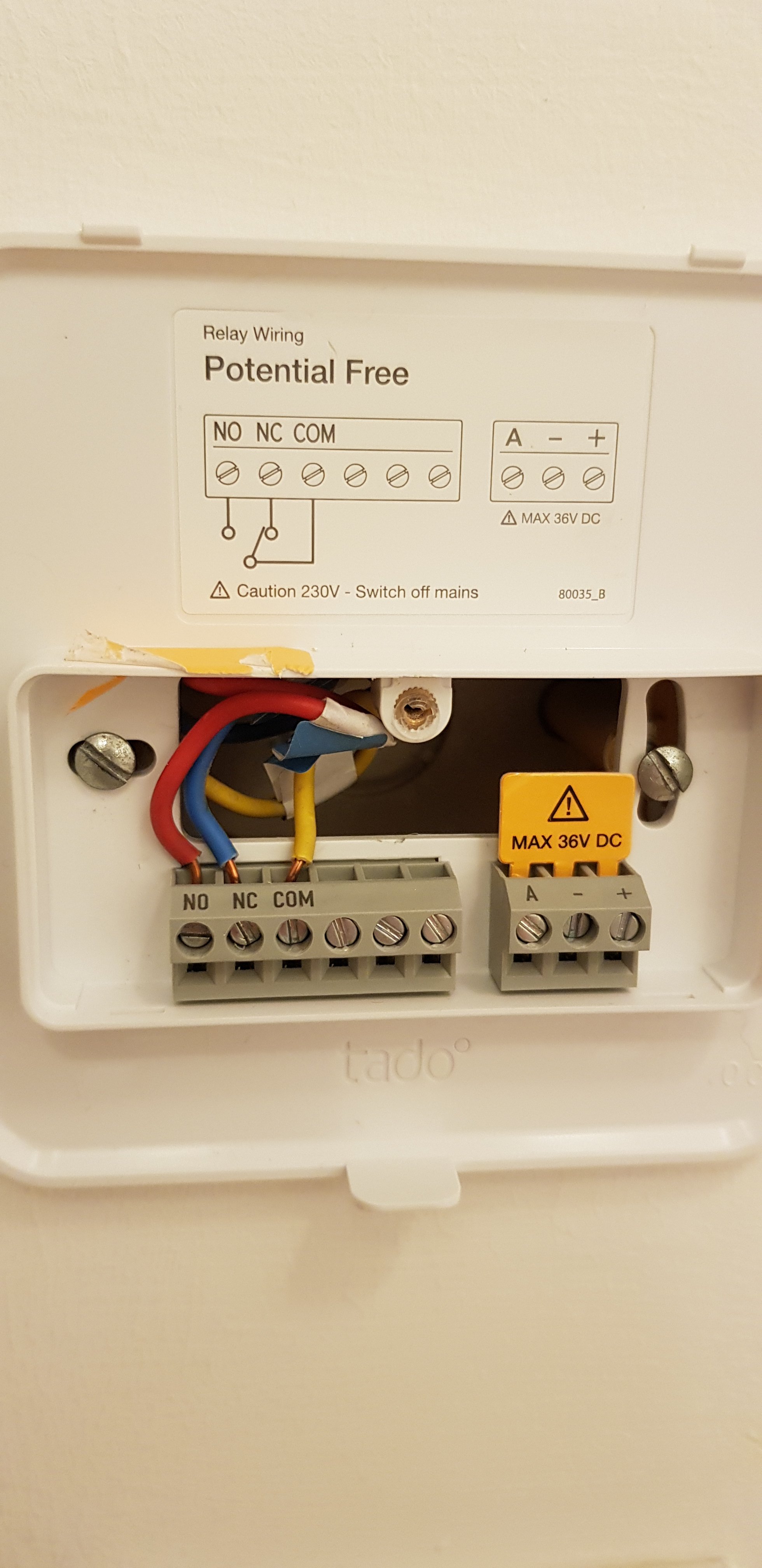

Hello,
So I swapped out the Original thermostat for a Tado Thermostat last night to my Potterton suprima 40 boiler (conventional non condensing) and and everything worked fine for about an hour then the heating breaker tripped on my fuse board. I turned the boiler off and flipped the breaker back on but now I've no power to the Thermostat and the heating won't fire up at all (Hot water still works). Could the Tado system have popped a fuse on the circuit board or worse fried the heating part of it?
I've slid the 3 way valve next to the hot water tank to manual bypass so at least there's some heat coming through the radiators with the hot water on but looking for suggestions as to why a smart thermostat would fry a boiler pcb like this.

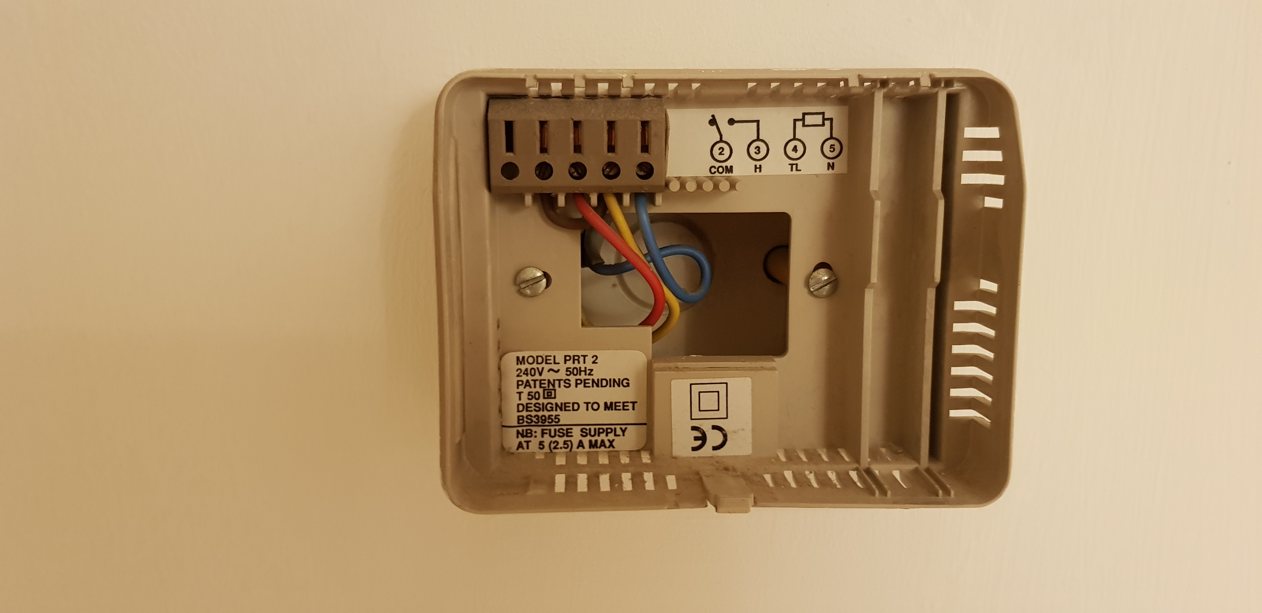

Yeah the wiring is fine I'd followed Tados simple instructions (only the 3 wires) and it worked for around an hour before tripping the fusebox. I should have said, the Tado is battery operated and just sends the signal to turn the boiler on. I've swapped my old thermostat back on and it's still dead. photo of the old wiring which has the brown jumper cable which Tado didn't need.
Pretty sure it's 240, this is how they told me to wire it up. You put in what boiler and controllers you have and they give you step by step instructions.

Do you have an extension kit ?
If so I think that should be jumper position 2 (240 volts)
Secondly you don’t need a cable in nc you would need to put it in a blank spot.
The COM is your common usually has 240 on it. NO sends power back to the controls to come on.
From looking at the old stat yellow wire appears to be your common and red wire to calling.
The blue wire is not needed put it in one of the blank ports.

Remove the blue wire and make it safe eg choc block
In short you've connected the live and neutral together:D
Also trim them conductors no copper showing
You could of blown your pcb best to get an engineer out
