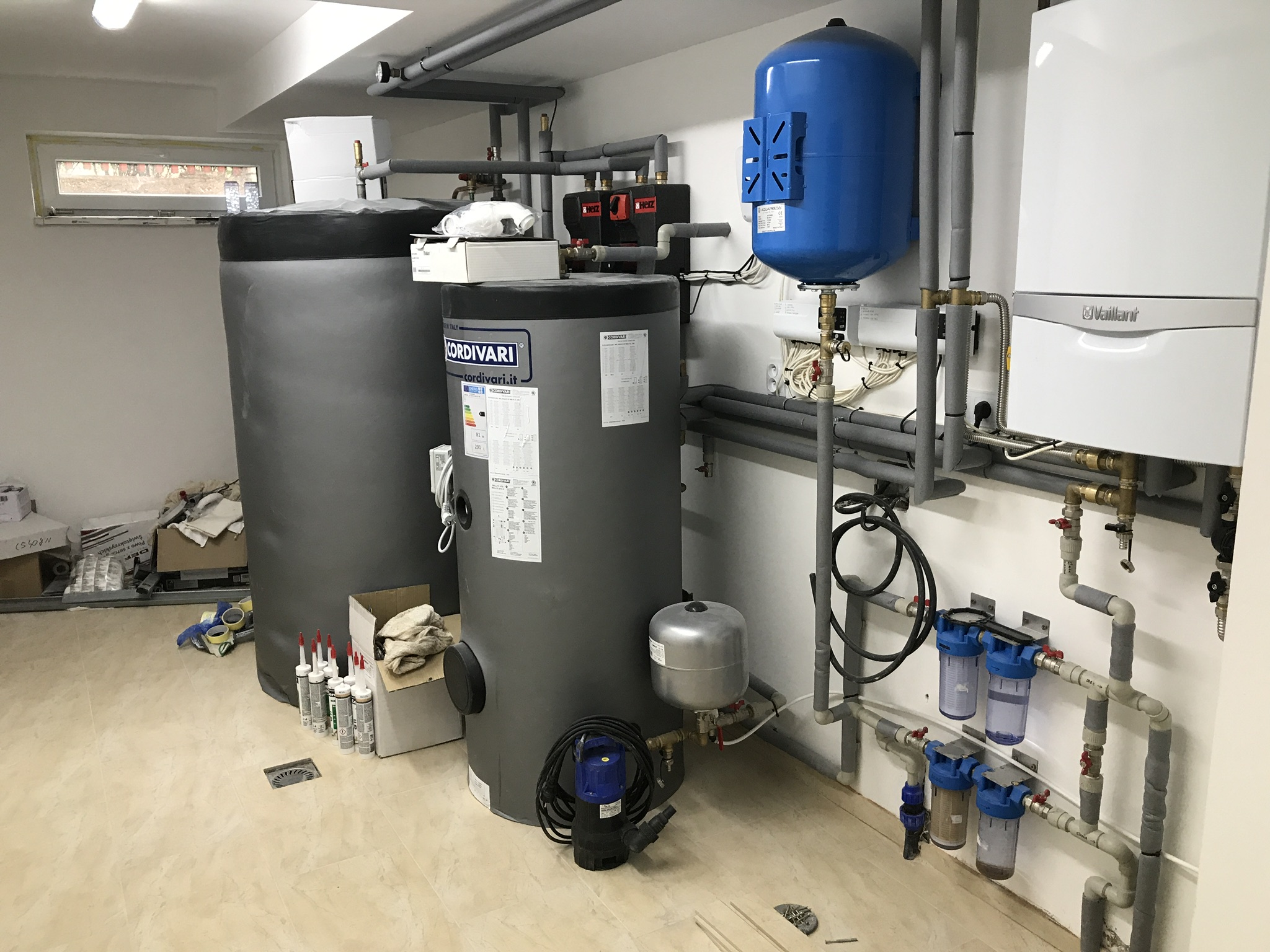

The room looks like this
Time to get someone in who specialises in solid fuel to have a look at the stove side

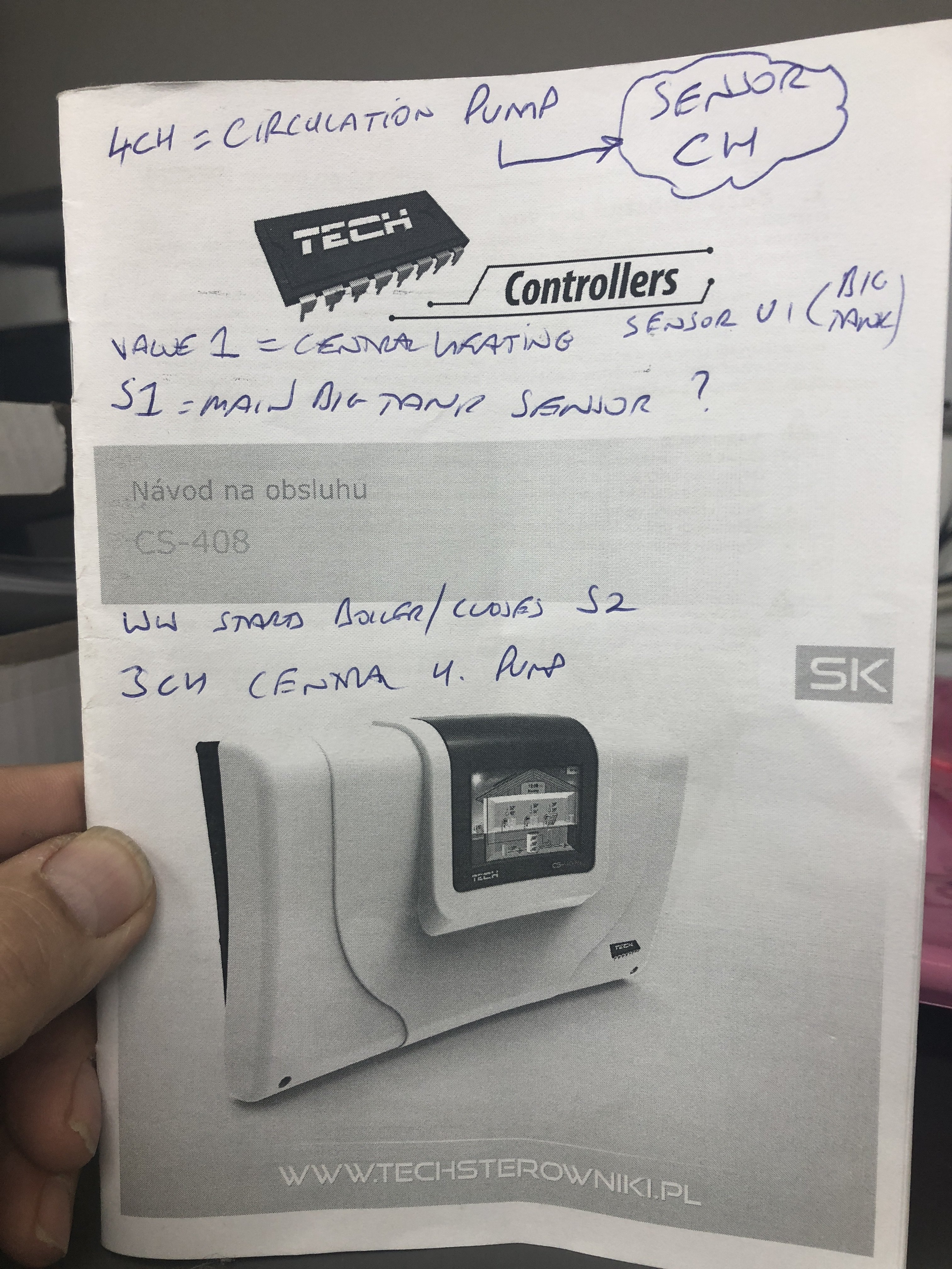

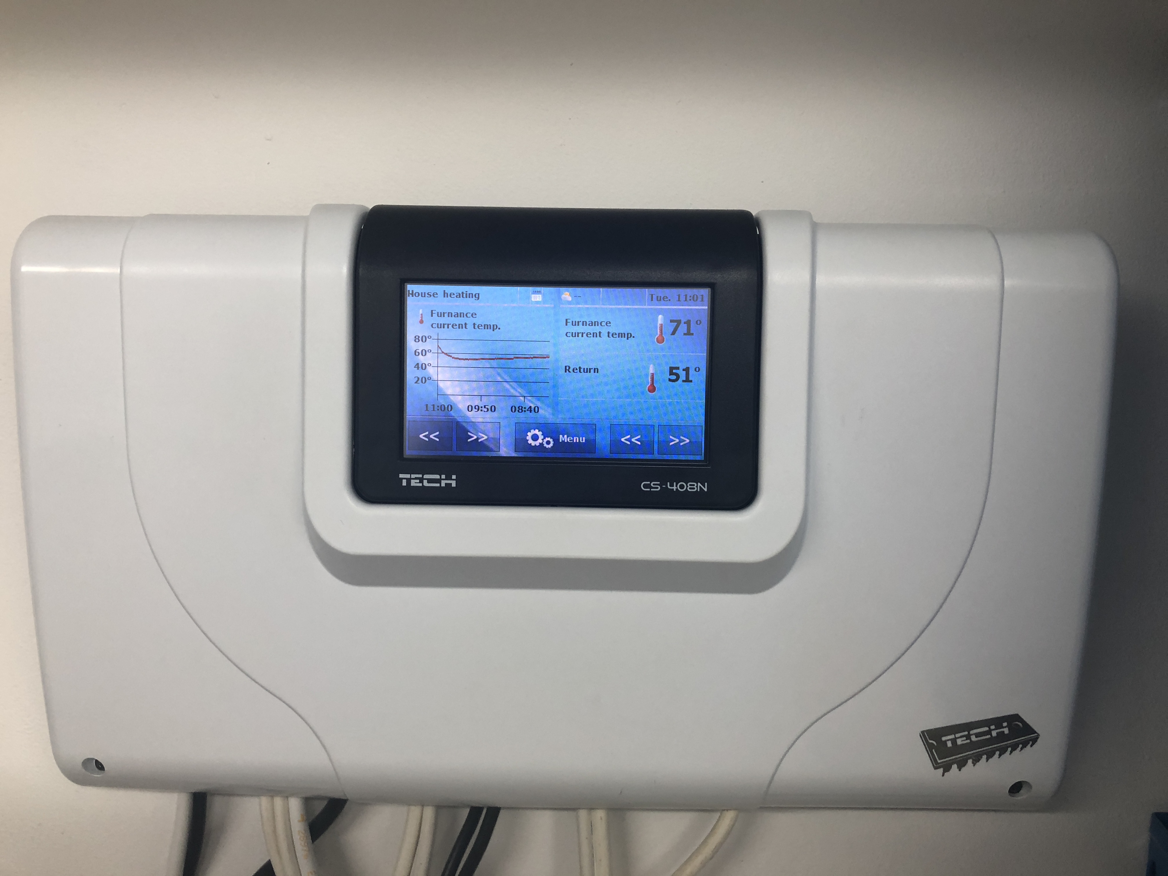

Thank you for the quick reply. I would be very interested to speak to your specialist colleague re a solution. I have attached a couple of images of the system controller to allow him to conduct some research prior to committing to any actions.

Hi Doug, a couple of things that may help prior to Ron flying out.
If you dont have it, can you get hold of the installation manual in english, this will include the wiring diagrams. Also not sure why controller is loosing memory, presumably , a small power cut ? - If this is typical of your electricity supply, then a small UPS system installed ahead of the power supply to the controller will help. I dont know about this system but generally updated parameters are automatically stored in non-volatile memory but some systems require you to do a "Save" after updating parameters, otherwise they are lost after a power cycle.
