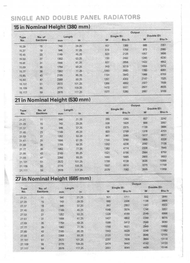

Does anyone here have, by any chance, a list of outputs for the older myson roundtop radiators. The ones without the convector fins? A Landlord i do work for has been told by a damp "specialist" that the heating is undersized which is why there's black mold on the walls and windows! He's asked me to check out the system. Visually it looks undersized and the rooms aren't exactly the warmest, however I would like to give him an acurate assesment. Most of the radiators are the old Myson round-top type.

Count it out at 1000 watts/m2 for singles and 1725 watts/m2 for doubles for a 50Δ T.
Not far away at that Steve.
I've always used this for old rads
[DLMURL]http://www.pipecasings.co.uk/downloads/download%20files/Radiator%20Output%20Calculator.pdf[/DLMURL]
Brilliant link Roger .. Many thanks.. Now down to some sizing work.
