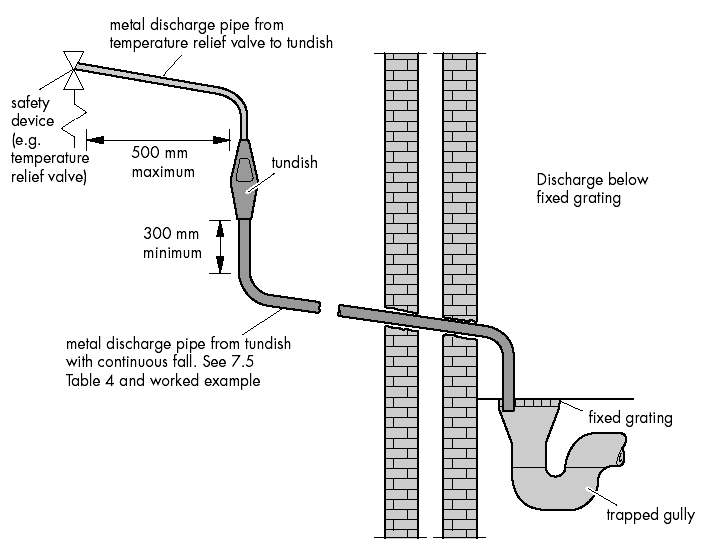

:D that’s bad there not g3 qualified
faults cylinder
incorrect installation of the inlet combo block/ prv unit (theyve used the balanced cold port on it so the cylinder cant use the expansion vessel as theres a nrv very serious as if heated the water will have no where to go suggest to dont heat the cylinder)
d1 over 600mm max
d2 not 300 min
single core exposed on immersion
wiring faults maybe?
faults boiler
overflow isnt suitable for blow offs / high temp discharge
if overflow is connected to drains tundish isnt trapped
filling loop is incoreect model should have two isolation valves

The internal unvented and boiler tundish’s need changing for either mactun1 or teslatun as it’s connected to waste so if left you could get smells / gases coming from the drain inside
And a few more clips wouldn’t hurt on the waste pipes
