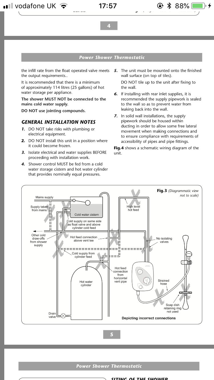

Can we double check , the shower is defo a power shower . ie it has an internal pump ? And uses tank fed cold and hot water from the cylinder.
Not sure myself pal , a power shower should not be mains fed , it should be fed by a tank ( cold from tank in loft , hot by the cylinder )
Can you confirm that the cold to the shower is a separate pipe all the way to the cylinder?
Also, you say there is no flange to the cylinder. You do, however, have a separate pipe all the way from the shower to the cylinder for the hot? And how does this connect to the cylinder? Can you photo or sketch it for us?
Hot comes from the cylinder as seen on the photo. When in the loft, there is a cold feet that comes from the tank and runs parallel with the hot into the power shower.
It's pulling air in from that
