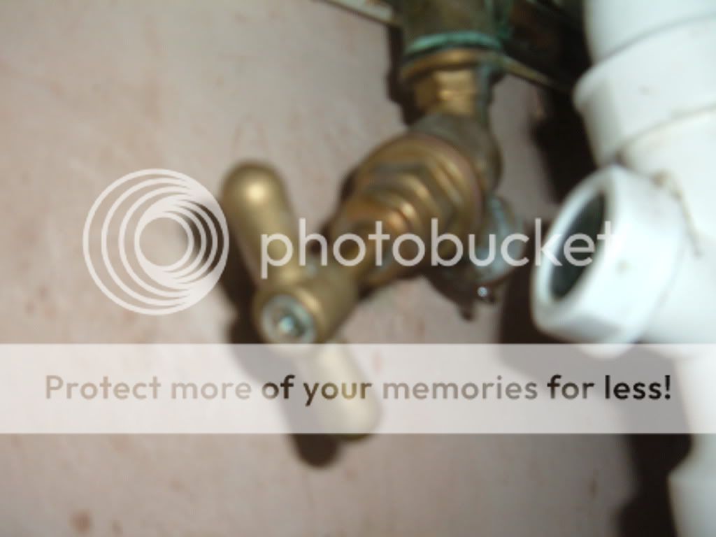

So the tap is fitted upside down. The blue you can see is the new connector. The open end of the tap is where the water is leaking from.
Hope this helps!
Thanks!

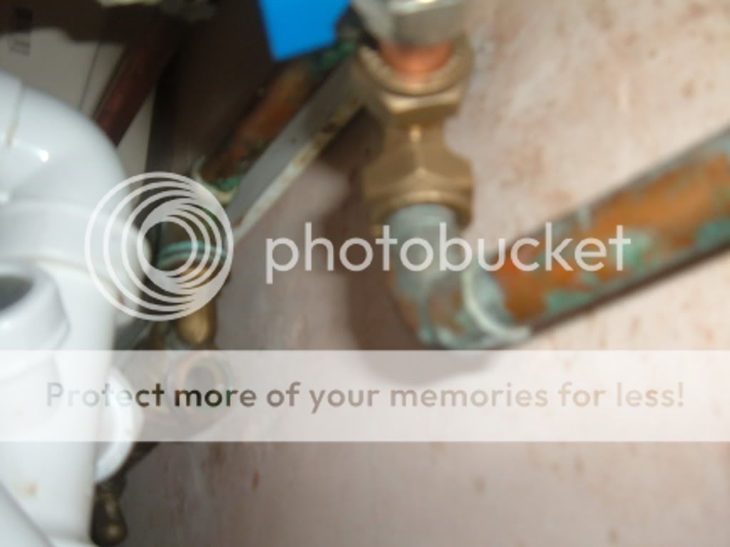

This might help you to see the type of tap.
Ah Ah!! now we can see what you mean good news this will be a quick fix for you go to your plumbers merchants and obtain a 3/4 BRASS cap with a couple of fibre washers and just screw it onto the tap and just nip it up gently with a spanner job done just leave it in place and it will be fine.He did not remove it because although it could be done it is tricky.good luck:)regards turnpin ps let us know how you get on
Well today I went and bought a 3/4 (22mm) Brass cap and fibre washers. It fits fine but still has a very small drip. Do you think it needs tightening a bit more or would a bit of PTFE tape round the tap end help?
Aye. Take the cap back off and stick the fibre washer in your gob. Seals better if it's moist! Wrap ptfe round your tap thread and put it all back together. Job done!
