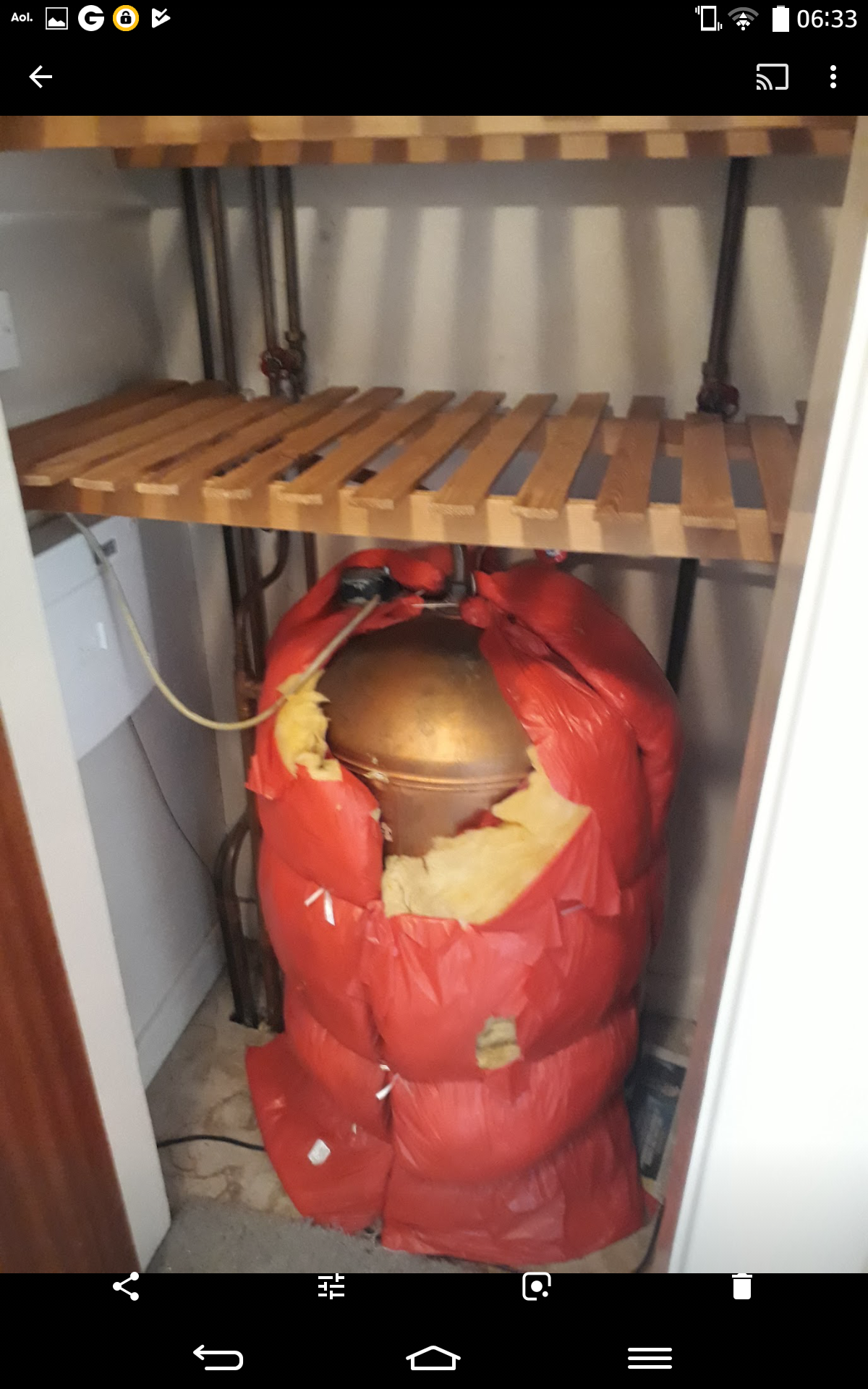

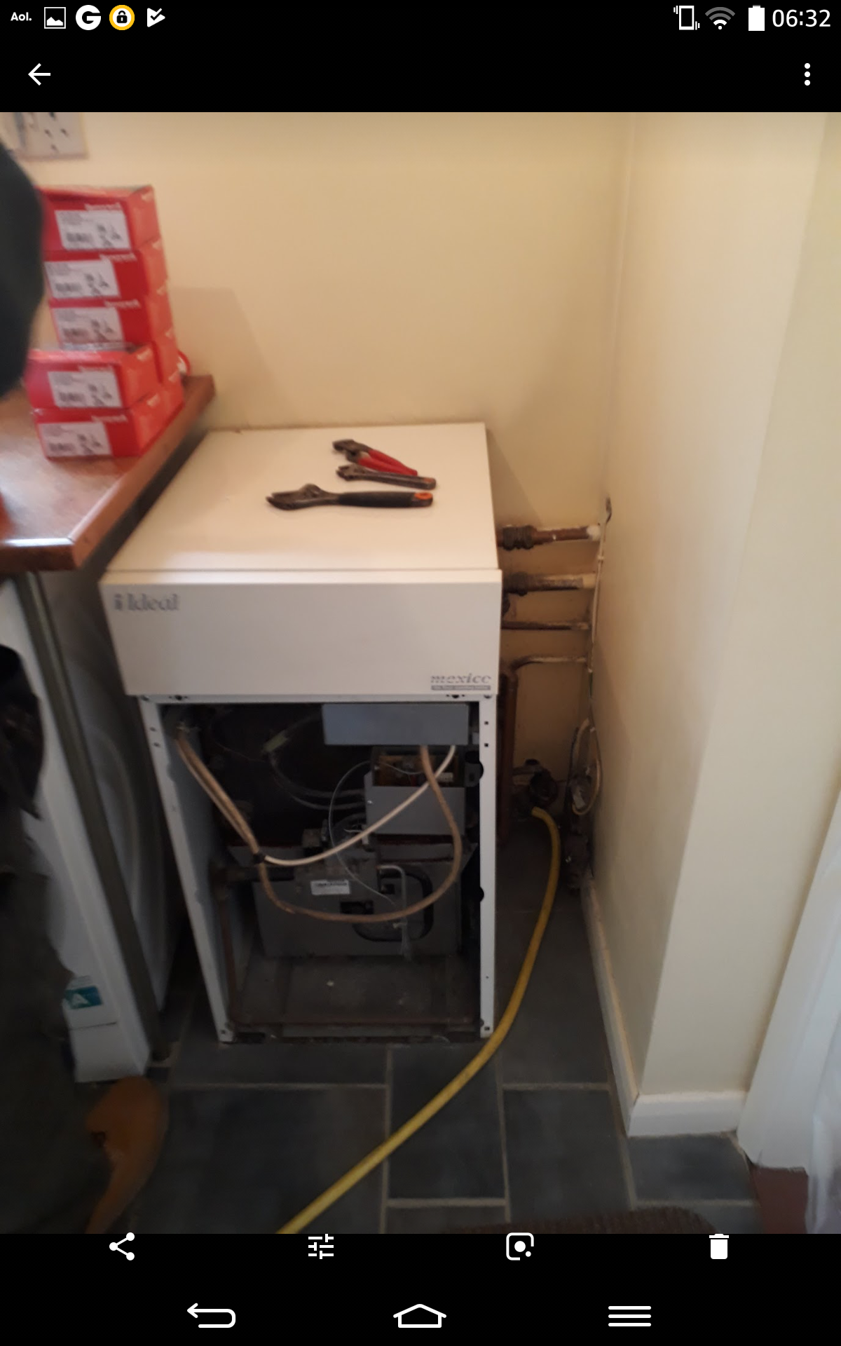

Got a upgrade to do on one of these the boiler is in the utility room fitted totally illegally as blanced flue is only 500mm away from a opening door into the house now the fun bit it has gravity hotwater pumped heating pump is next to the boiler , cylinder is upstairs has no control at all and no insulation only a red jacket , vent and cold feed connect into the gravity primaries , planning on fitting a worcester greenstar classic 30CDI wall mounted with vertical flue , new vented cylinder , dont want to go sealed as has 30 year old pipework in sand and cement screed downstairs but need to do a s plan somehow cold feed vent and wiring proving the awkward bit any ideas guys or alot of chipboard is going to have to come up or i have to go sealed but really is a last resort cheers kop

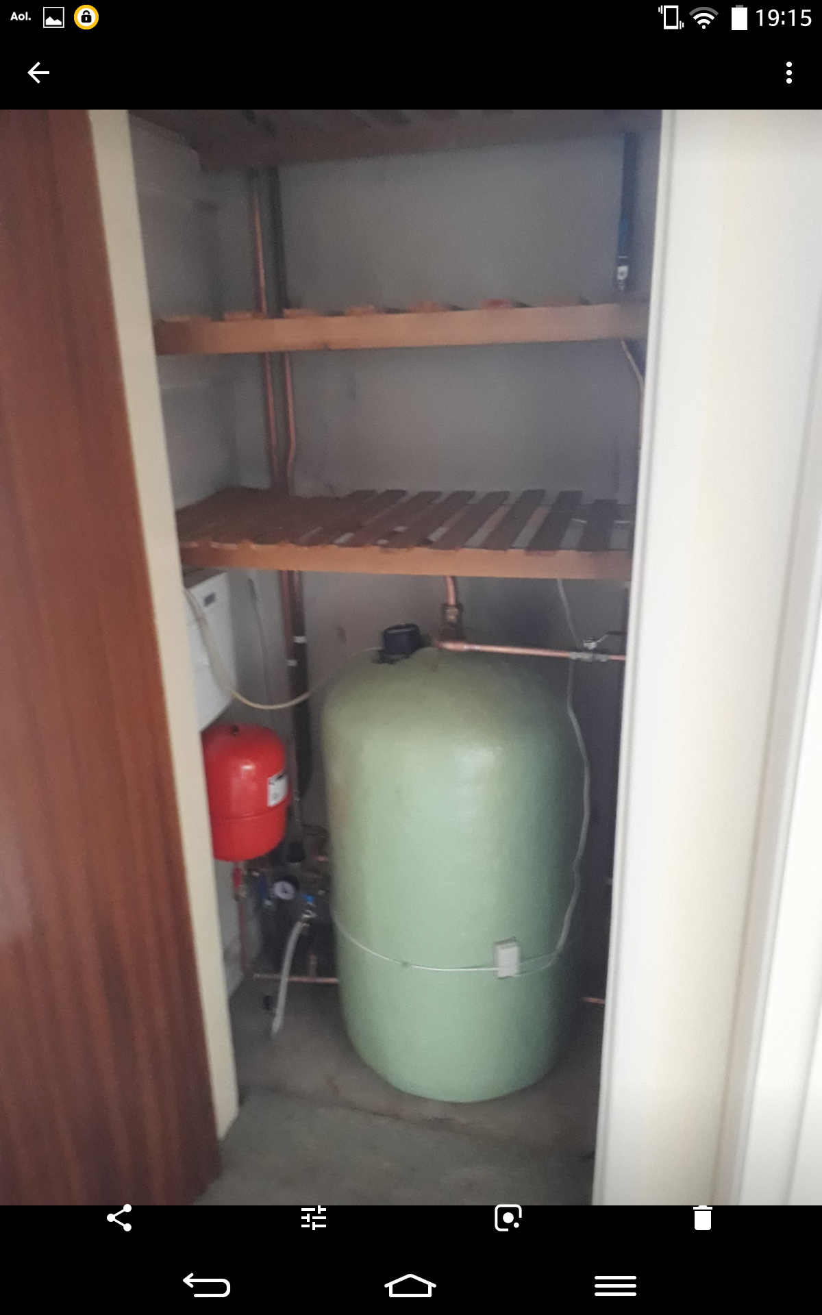

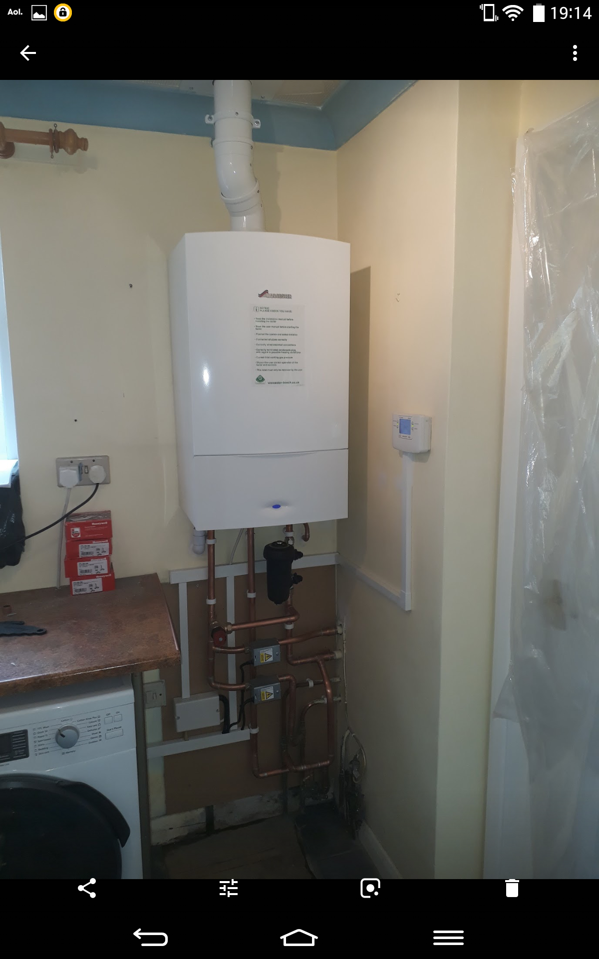

Customer went with it so fingers crossed thanks for all your input guys . cheers kop
Well got it started and its not looking good 15mm feeding upstairs and 15mm downstairs grrrr no way of altering this all pipework buried in screed better get the wand out . cheers kop
Before not a pretty site .
Not perfect bud but sometimes you have to work with what you have main thing is the customers well happy, you had a busy week mate
Not bad mate. Still trying to clear the back log from the snow. On a boiler change myself the start of the week, With a vertical. I fu****g hate verticals.:confused::confused::confused:
I actually like the install, for what you had looks tidy and neat. Most important customers is well happy and that’s all it counts. Did you have to re pipe a lot?
