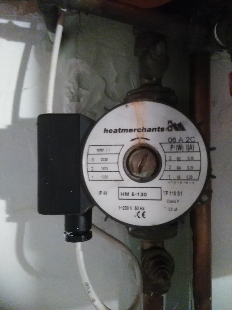

It looks like the pump of my gas boiler has given up the ghost. I'm pretty sure it's the pump that is the problem because the boiler starts and stops after a few minutes - I believe because the pump isn't circulating the water around the house so the boiler cuts off automatically.
We had a plumber call over 2 or 3 times over the years. The solution has always been pretty much - take out the bleed screw of the pump, twiddle around with a screw driver at the screw inside, and then it would start working again.
But this time no joy trying that option. It doesn't turn at all.
Here is my pump I currently have:
I'm wondering if this alternative pump would suit my needs. I don't really have 300 - 400 euros for a new pump, which I believe is the going rate. Then I will hire my local plumber who should be able to fit it for me.

I believe all the salient details on the label are the same as my current pump - 230V, 50Hz, Class F IP 44.

The first pump you suggest is made for a Ravenheat boiler and the third one for a Bosch boiler. So they may not be suitable for your boiler. The second one (CBS ) is an unknown brand. I suspect it is an oriental copy of a Grundfos, so of doubtful quality.
I can't make out if your pump is an HM 5-130 or HM 6-130. The difference is that "5" means a 5 metre head and "6" a 6 metre head. All three pumps you suggest are 6 metre heads, so they would also be unsuitable if you have a 5 metre head at the moment.
