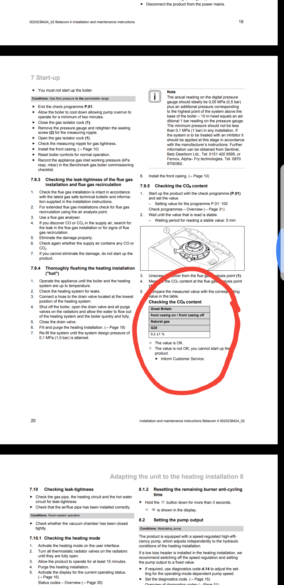

The tolerance for the co2 9.2-10.2% for max and minimum. I don't know why this is not stated in the manufactures book.
The tolerance is 8.2% - 10.2% and it states it on page 20.
