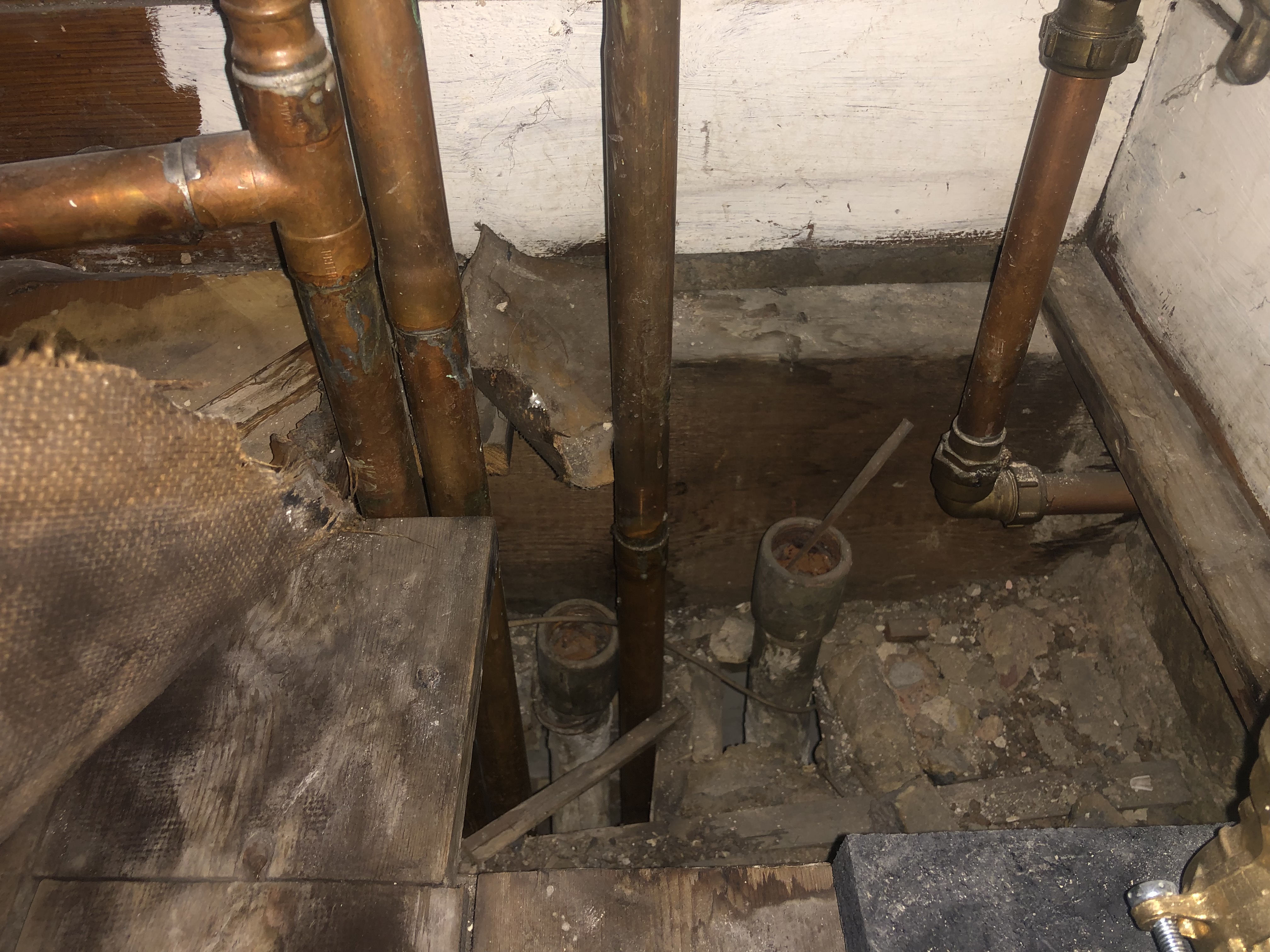

Pic of some ancient pipe iron pipe under the airing cupboard floor (no longer in use). For scale all of those copper pipes are 28mm except the one in the corner with compression fittings which is Imperial (1 inch cold to bathroom reduced to 22mm at elbow). The cold feed from tank to cylinder (not in picture) is still 1 inch iron, good flow through that. In case anyone wants to know the 2 pipes on the left are feed and return to cylinder and the one in the middle is hot water from cylinder.
