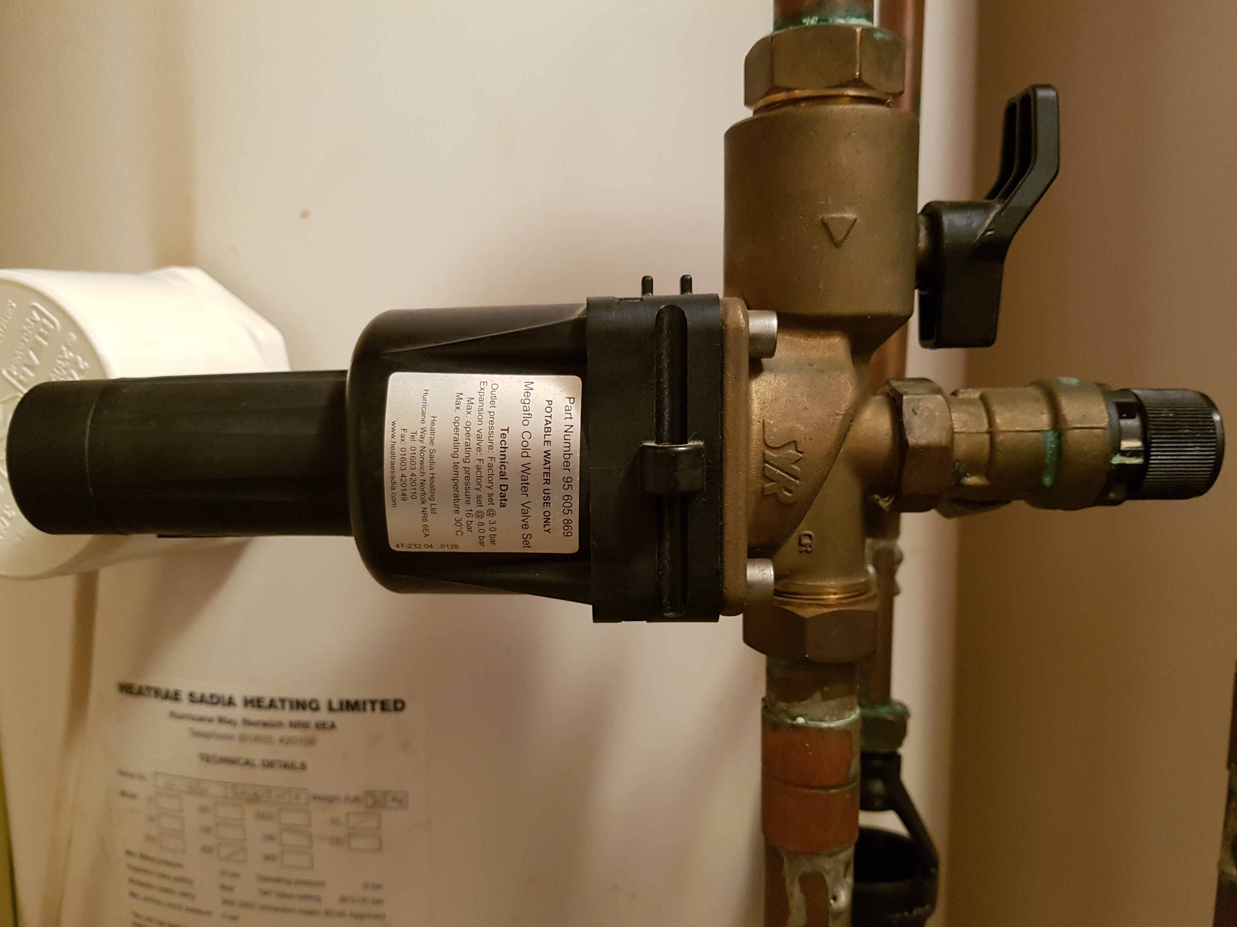

Hoping someone on here could assist with a query I have regarding a valve on our hot water draw-off from our Megaflo system.
Have called out British Gas Homecare engineer as hot water pressure has decreased on all taps/baths/showers to the point that it takes ages to fill bath/sinks or (mixer) shower is running tepid.
Long story short, he is going to replace a large pressure relief valve but as part of his investigation he noticed another valve on our 'hot water draw-off'.
He didn't know what it was (thought it looked like either another PRV or a Mixer valve) but couldn't understand why this would be on the hot water draw-off - He called a couple of guys who could not identify it or its purpose.
He removed it to check it and it appeared clear, but when he to put it back in place, it started leaking when the cold water infill was turned back on.
He has said that when the other PRV is being replaced (tomorrow), he will take the leaking valve out and replace with a piece of pipe.
I'm looking for help to identify what it is, and would it be safe to remove it and replace with pipe (I'm thinking it must have been put in for a reason)?
Any help that anyone can provide would be greatly appreciated.
Many thanks
Steve

What is still a concern though is that the unknown valve will be replaced with a piece of pipe as I'm sure it must have been put in for a reason.
Has anyone ever seen this sort of set-up before? (if it helps, the valve turns round a scale from 1-6)

PS. I'm now 99% sure it's a Boss Pressure Reducing Valve
We do have 1 on the inlet also - that's the one that he is going to replace tomorrow (as he had to order the part) - just need to have a night off from hot water - oh well, at least it gives me a reason to use my gym membership tonight (for the 1st time in about 2 years) lol
One other question, would it be better to ask him to replace the 'unknown' one with another of the same type to save any potential future issues?

The unknown one on the output has always been there as far as we can remember (I'm not aware of any previous issues that may have warranted the fitting of it, and we bought the house new).
The only way I can work out why its there is possibly to regulate the pressure between the infill to the tank and the outflow to the taps/showers -
Now again, I have absolutely no background in heating/hot water so could be completely off here - but by my reckoning, if the outflow pressure is greater than the infill, then could this be the reason why the hot water pressure at the taps is low (i.e. turn on tap, works well for 20 seconds but then tails off, and then after closing the tap for a couple of minutes, this allows more water to flow in to the tank, building the pressure back up so that again when the hot tap is turned on, the pressure is okay for 20 seconds). So by replacing the large known PRV (if this is faulty and reducing the pressure in), this would hopefully resolve our low water pressure issue).
Finally, if the unknown valve (PRV on the outflow) is replaced by a piece of pipe, would the pressure be equal (i.e. 3 bar in = 3 bar out), or is it possible we could still have an imbalance (i.e. more out than in) and still have the same issue with low water pressure? The reason I ask, is I don't know whether it would be better to insist for him to replace like for like instead of removing and replacing with pipe.

Hello YorkshireDave / Steve-Scotland [the OP],
As You intimated Dave no Plumber is going to put a Pressure Reducing Valve [Honeywell DO5] on the Hot Water outlet unless there have been previous problems caused by the water pressure on the Hot Water supply pipework - especially as You have also mentioned there are 2 other Pressure Reducing Valves on the Mains pipework.
However - before just `removing it` a Plumber should investigate why it was fitted in the first place.
IF it is just removed there may be an immediate problem with the Hot Water pressure.
To Steve-Scotland [the OP]:
This is where I have to advise that a Plumber is employed because they will be able to look at the Plumbing / Pipework etc. in your Home and will have a better understanding of the RISKS associated with what I am suggesting:
I would suggest `experimenting` by very gradually increasing the pressure on the Pressure Reducing Valve - that is going to be better than just removing it and `hoping for the best` !
I would advise that when the original problem is fixed by BG some investigation is done by gradually increasing the pressure on the Honeywell Pressure Reducing valve to see if anything happens regarding too much pressure at the Taps / Shower etc.
Before doing that `Test` I advise that the Washing Machine / Dish Washer water supply valves are closed and the hoses disconnected from the valves as a precaution to eliminate any chance of the hoses bursting or damage to the Appliances - because I would not rely on standard quality Washing Machine valves to hold back possibly very high pressure while the `Testing` is going on.
`Better be Safe than Sorry`.
Something else that occurs to me while writing this is that IF the incoming Mains water pressure is so High that it requires 2 x Pressure Reducing Valves BEFORE the Unvented Cylinder / Megaflow and another after it is there a possibility that the Unvented Cylinder is still being fed with Mains water that is under too much pressure for the Cylinder specification ?
