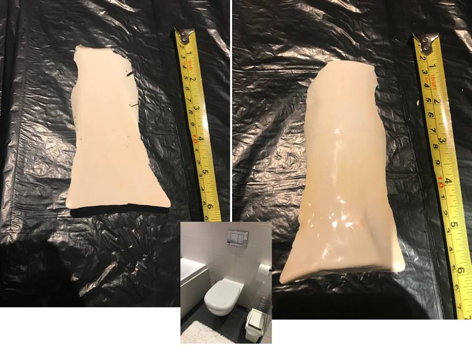

Hoping for some help to identify this - images attached -
  • I found this in the bowl of my wall mounted toilet in the upstairs bathroom
  • geberit parts but installed by previous home owner
  • The toilet works and there’s no obvious external leak or smell
  • I’ve got 2 kids so not impossible it’s from elsewhere but it looks like something that’s been exposed to liquid for a long time
My guess is it didn’t come from the cistern as it’s too big to travel down unnoticed and feels like ceramic - so more likely from just after the bend.
We had some work done two years ago to fit a new en-suite toilet toilet on the same system so could be from that. In general though most of the system has been looked at recently.
Any ideas before I start pulling tiles off the wall would be really appreciated - again right now the system works fine as far as I can tell and not sure if this actually needs fixed at this point
Cheers
John
The other thing it could be is tile grout.
Tilers have caused many issues pouring the the bucket of water they use for cleaning up grout down drains.
I wouldn't go as far as taking tiles off the wall if everything is working correctly. If you want some piece of mind, hire someone with a drain camera to inspect the drain beyond the pan

Grout and / or adhesive that had water flowing over it while still soft to give the shiny appearance. As to ripping the place apart... "if it ain't broke"...
