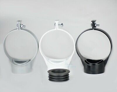

So this -https://www.NoLinkingToThis/p/floplast-strap-boss-grey-110mm/93635 (requires 54mm hole cut in pipe) and just push in push fit access plug.
I could then pull out the access plug and grommet and the 54mm hole will be plenty big enough to get a snake jet/rods down.
Then yet another option is a 50mm boss adapter, but how would i fit an inspection point into this that is removable?
Plus i'm not sure what size bit would need to drill into the soil for a 50mm boss adapter, presume it would be around 64mm???
But what pug do o need for this that i can just push in as i have no 50mm pipe and purchasing a single length for 4 " of it is madness.

He also down the main rainwater drains and gave me 4” rubber band collar for free.
