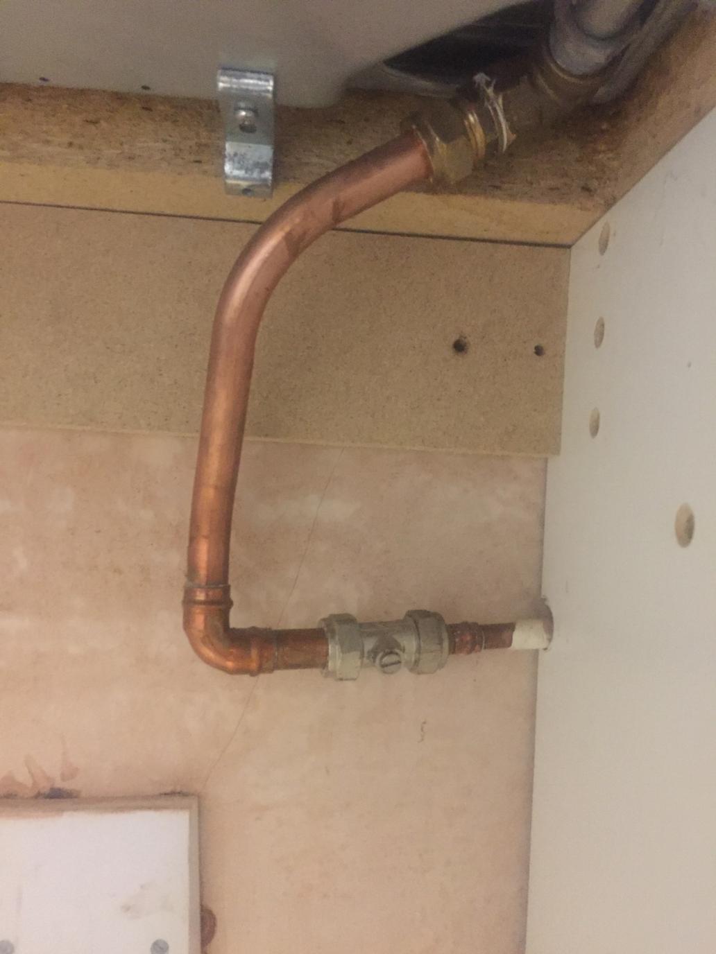

Always check under Hobs and behind cookers ! How it should not be done found this last week
