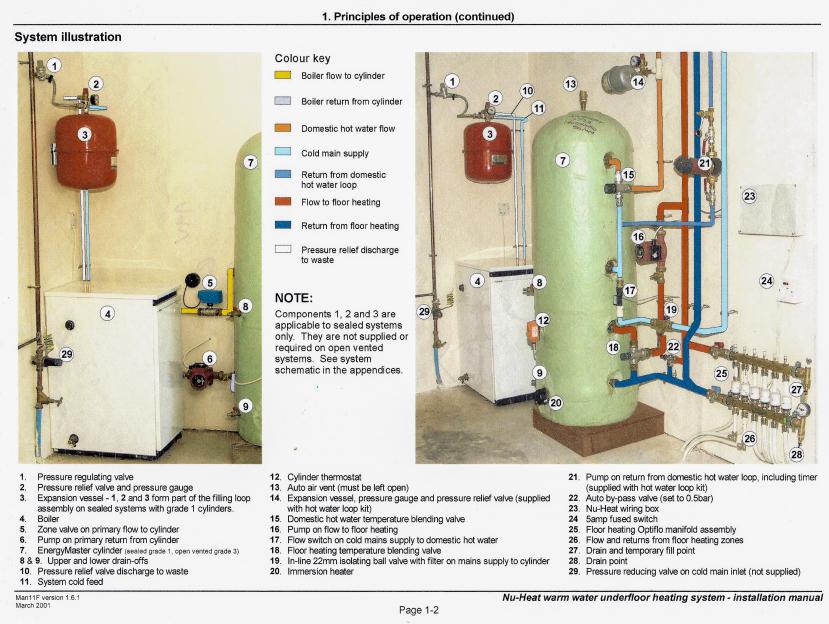

If there's pump on the underfloor the tmv should be built into that for the underfloor so it should have one
If you could post some pics up if you don't mind

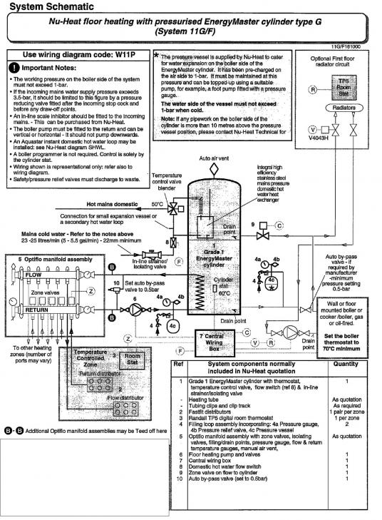

Attached schematic ... change is as per my diag in post 1 .... added shunt pump & one way valve
Also this pic may help .... which is the above plus a TMV i.e. what I want to put in place.
As you can see in schematic in previous post above it was not included in the design for my system, nor in provided kit.
Been running since 2002
Look at item no 18 :)
As I said above that is not included in my design, look at the schematic.. in Post 8 that is my system ..no TMV on heating.
The picture was just for info, to show parts .. as explained I intend to add TMV to match this picture.
