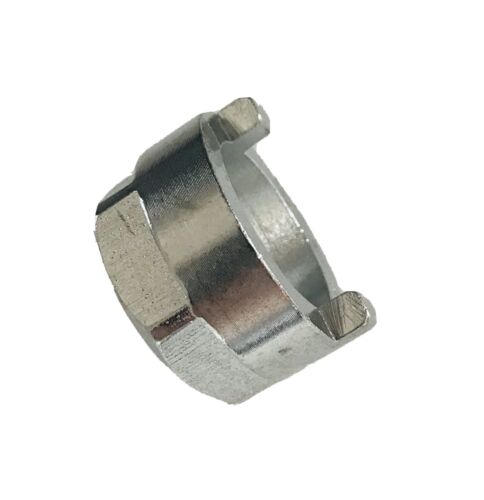

my main issue though is ive moved all the knobs and faceplate but to get to the cartrige it looks like i need a tool with 2 specific lugs on them 32ish mm apart
does anyone know where i can find such a tool? (searching google hasnt been helpful) or even identify which shower valve i have so i can see technical drawings.

Flat screwdriver and a hammer ?
No other than making one or contacting the manufacturer
