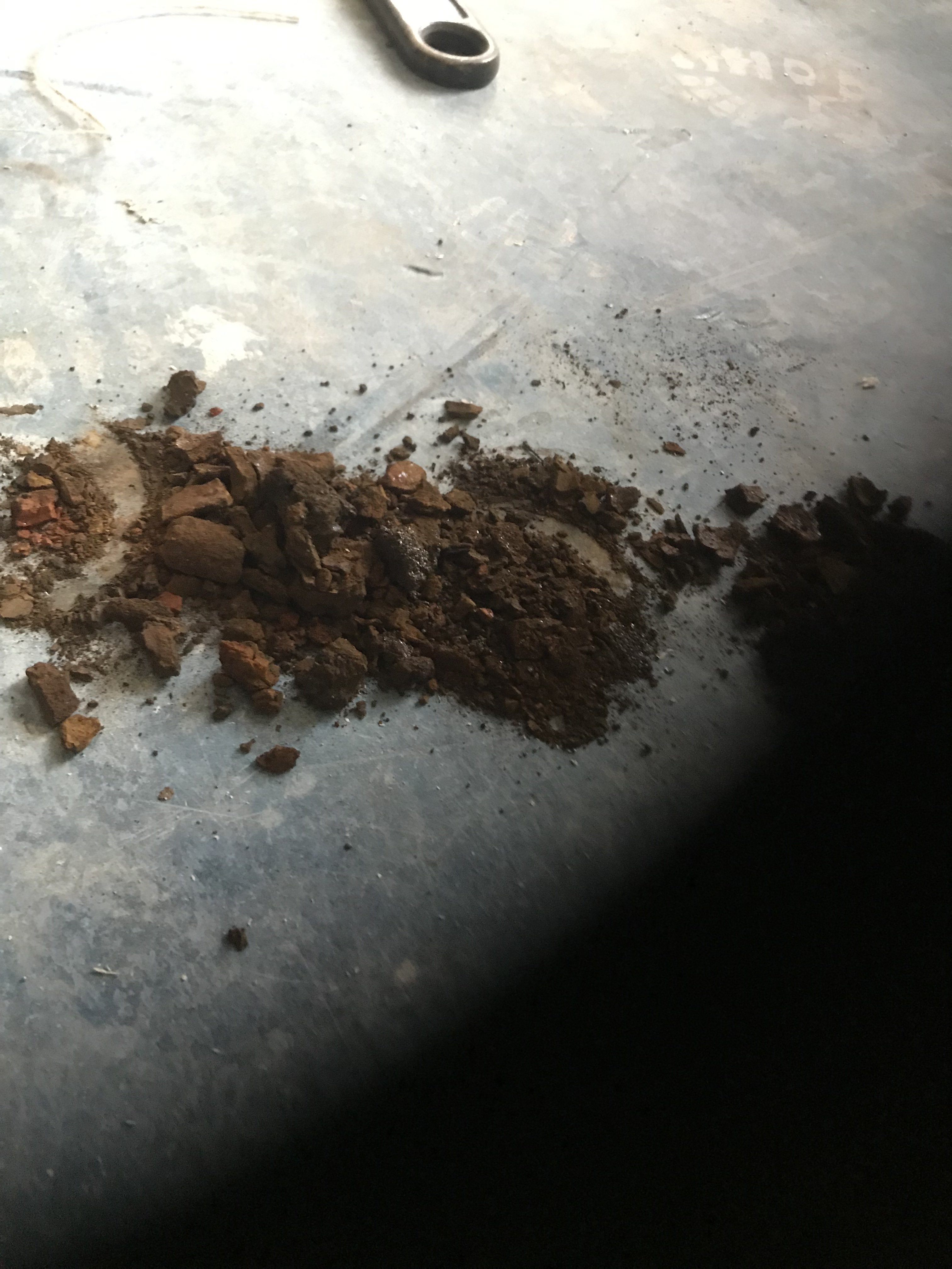

    Morning people, I’m in the middle of a listed building refurb. The customer is having overlay ufh throughout and using the original cast iron rads as the supplementary heat. I’m removing the top and bottom entry bushes to have them at the bottom, there’s lots of dried magnetite coming out. I’m thinking of hooking up a powerflush machine whilst we’re at building stage to clean them. I’ve put some of the big lumps into an acid/ water mix and it’s not limescale . What chemicals would give satisfactory results on cold water powerflush?

    It probably best to keep doing what you are doing.
    Remove the entry bushes, belt the heater around a bit and then tip out the dried magnetite.
    I would be hesitant putting too strong a chemical through the rads, due to the old paper gaskets used between each section.
    It may just be worth flushing with water after getting as much magnetite out while the rad is dry

    use a rubber mallet and a powerfull magnet as well as
    some of the right type of sentinal, or other chemicals.
    Ring up their technical number
    they will give you good advice. X800 Sentinal but keep it going round loads of times or soak if you can find big enough old tank.
    We used to bung them in the pine strippers vat years ago

    Just remember, whatever you use, make sure the PH is properly back to neutral when you've done. I suspect it will take as long to do that as clean 'em.

    great advice...forgot that ..and if they are not going to be used for a while, do not store them dry, introduce some chainsaw oil insude and roll it around, then clear it out before use.

    Flush them with mains water before fitting

    I’ve connected all the rads in series and going to run some x800 via a powerflush all day tomorrow and then flush em out with cold water.
