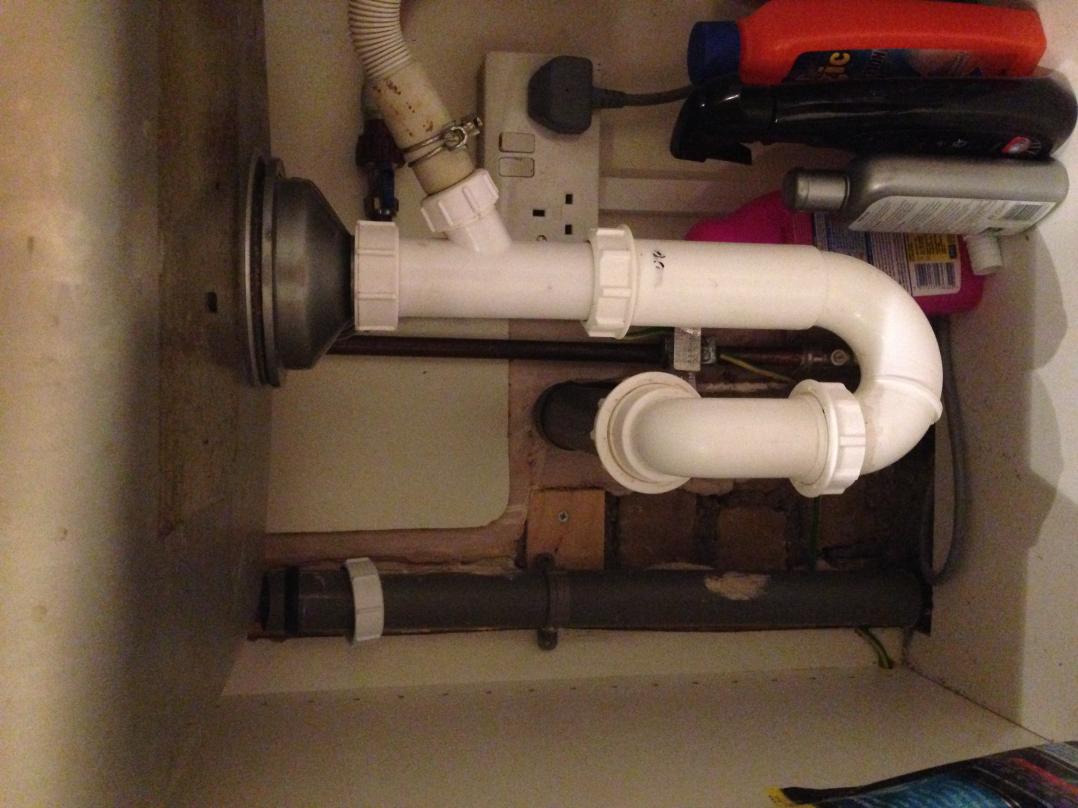

Thanks for all your help so far, really very helpful. I've attached a picture of the pipe work under the sink so you can see, the AAV was attached to the top of the grey pipe at the back. As you can see I can't get it higher IMG_8300.jpg
If I run the tap the water drains absolutely fine now with the AAV removed, surely if there was a blockage of some sort the water would start to rise up? It only seems to be an issue now when the sink is filled up and the plug is taken out that it's very stop start....
Next door is on the opposite side of the wall so I'm guessing the pipe work runs underneath the flat and out the opposite side of the building
sounds to me like theres a possible blockage or partial blockage in the main stack either on the vent or the wet side
long run under floor will be full of crud ive had several like this usually dodgy flat conversions should have been run in 2 inch with a fall i bet if you lift a floor board this is just laying on the ceiling below
