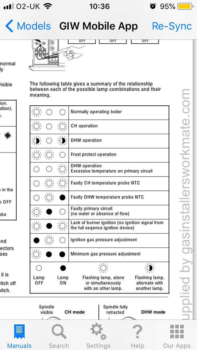

I will attach some pictures. I just want to know where to start looking before I go there therefore I am asking you guys. Apparently the green light is flashing and he tried restarting the boiler with the red button but nothing so he turned the mains off but nothing changed.

Sound like the pump flow switch isn’t making air in the system.
Remove the pump flow switch press it in until the pump kick in. Toppup the pressure. If not then you need a new pump flow switch diaphragm or pump.
Please find the error codes attached.
