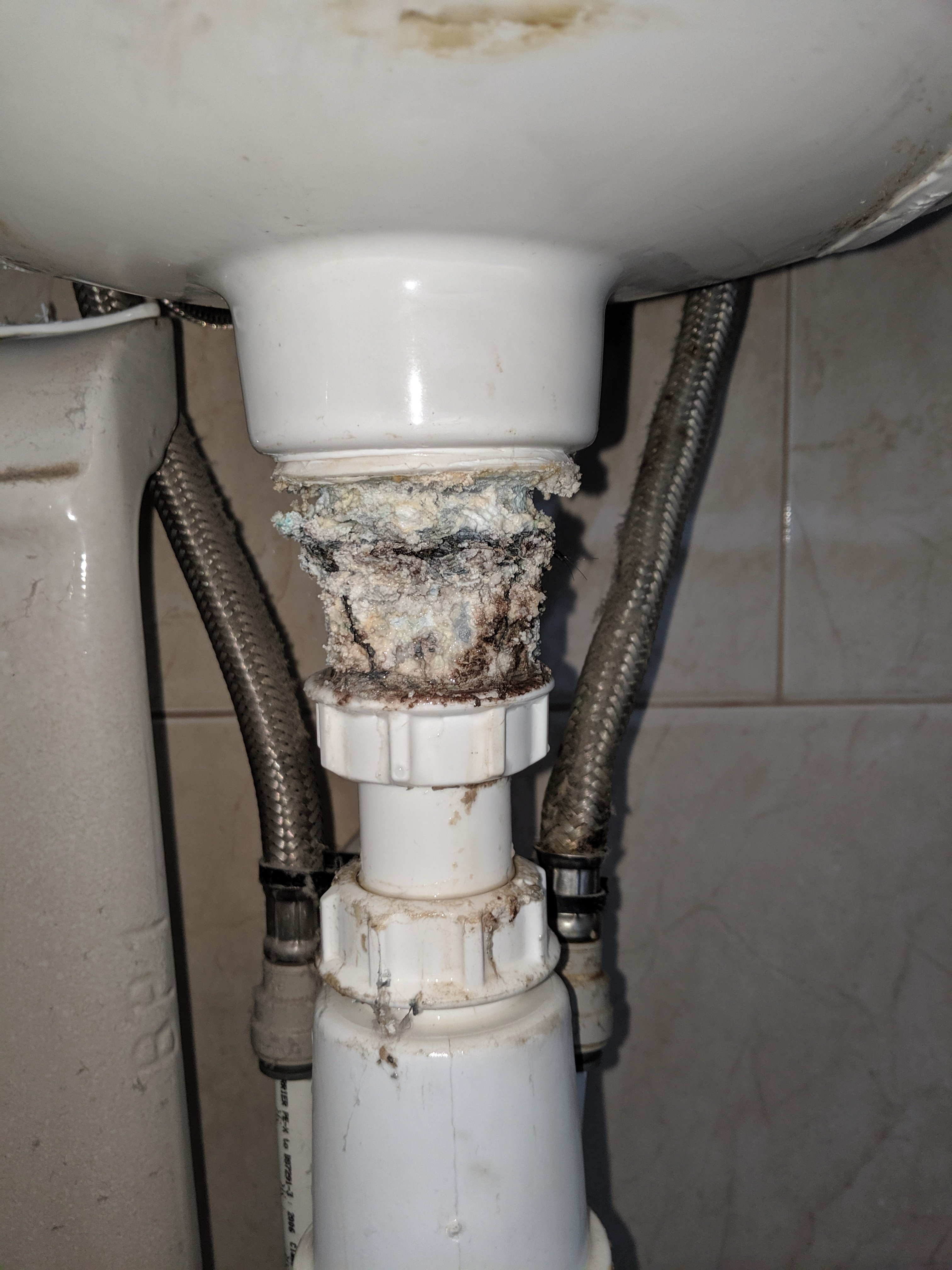

About 8 I would say trail and error really it helps stop the water running down the threads when overflow water enters the waste this is often a problem on vanity unit basin wastes and combined bath waste and overflows only yesterday I attended this one . Kop
