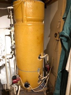

    Hi All, I have an odd problem, we moved into our house about 5 years ago and have always had a problem where the bath tap runs from scorching hot to luke warm after it's been running for a minute, despite the heating being on all day, this process can be repeated after switching off for about a min. I think the whole heating system is the original one from about 30 years when the house was built. It's a conventional gas boiler (not combi) and for some reason we have a large combination hot water cylinder, despite it being a 4 bed house with loft (no separate cold water tank). The other taps, en-suite shower, around the house all seem to run hot water continuously with no problem. Any suggestions regarding the problem would be welcome, thanks.

    What make and model of boiler do you have and what make and model of cylinder?

    I'm not at home to check the exact makes, I believe it's a Potterton, 1980's gas boiler and here's an image of the cylinder.

  12. Harvest Fields
    Is there a mixer on that cylinder?

  13. Leaky123
    Leaky123 New Member
    I'm sorry, I don't know, what am I looking for? Does the photo above help?
