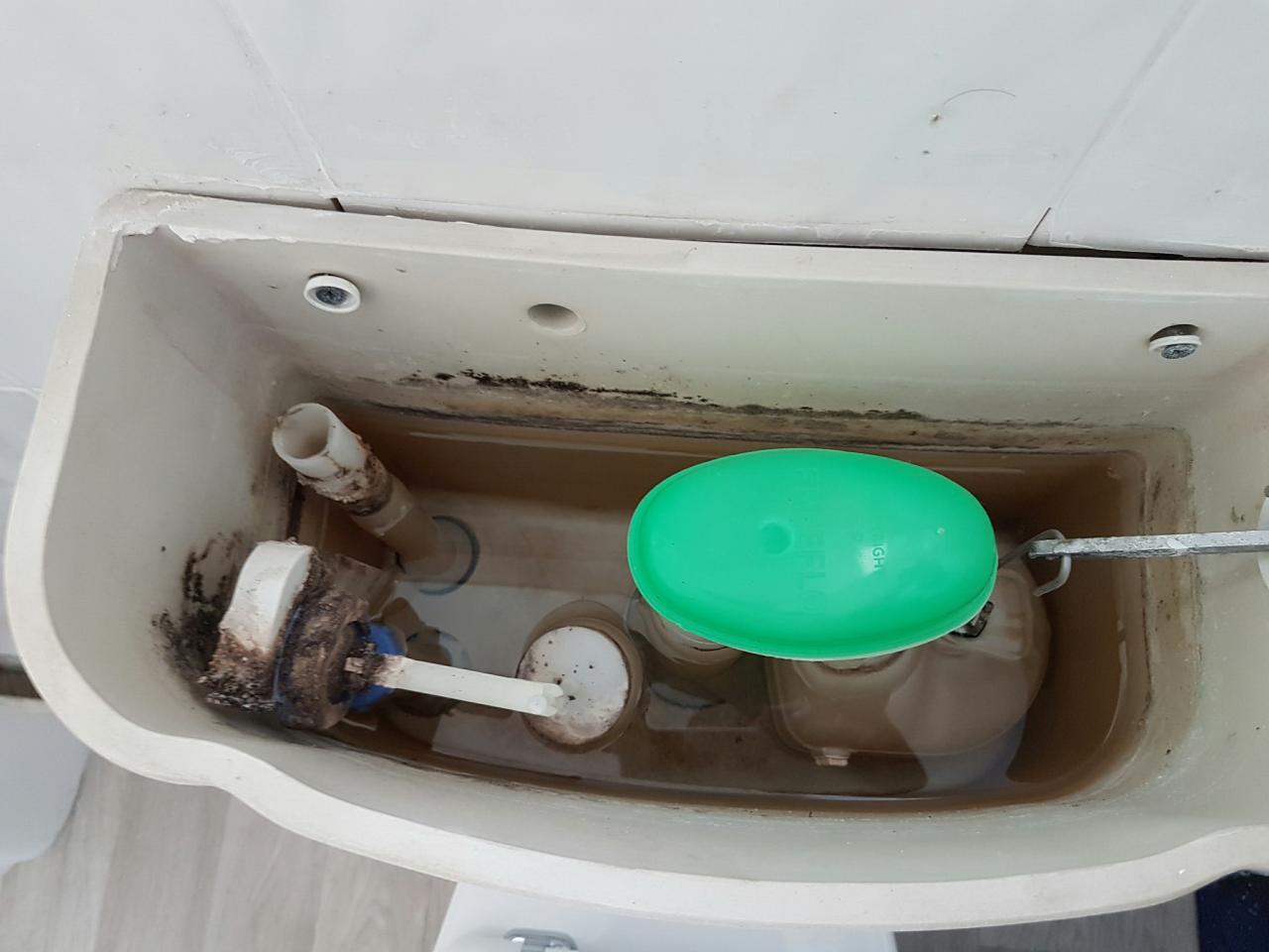

could you post a pic up looking down into the cirster (lid off) please
I've stripped out the inlet valve 29cm tall) and syphon (30cm tall). Syphon has a split in the diaphragm.

Should be able to re fit a new set of internals no problem
Fluid master siphon
Fluidmaster® PRO Universal Dual Flush Syphon - Fluidmaster PRO Series - Our Products
You won't require your over flow any more
http://www.NoLinkingToThis/p/fluidmaster-blanking-off-plug/65267
New inlet valve
PRO Bottom Entry Fill Valve with Heavy Duty Brass Shank - Fluidmaster PRO Series - Our Products
http://www.NoLinkingToThis/p/wc-close-coupling-kit-white/84958
Or
http://www.NoLinkingToThis/p/euroflo-close-coupling-cistern-bolts/48787
Depending on if you have bolts showing in your cistern

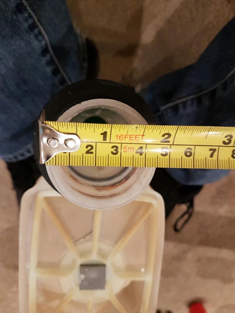

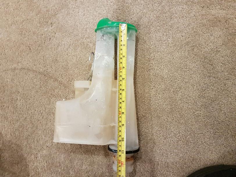

Just another quickie. The syphon I have has a thread outside diameter of 47mm (1 3/4"?) and the height of the syphon is 300mm to the seal and 350mm overall height (see pics).
The replacement ones in screwfix, toolstation.. etc show a diameter of 38mm and a length of 9".
Pipe size and OD differ, so is mine a 1 1/2" standard? How critical is it to get the right height syphon as seems the old one is quite high.
Height matters with the links I put up you can set your own height (adjustable)

The same size as the OD of the syphon. It was a tight fit when I pulled it out, so about 47mm (1 7/8").
Will be fine then with a 11/2 (41mm) siphon
