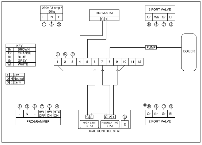

Have an unvented to change which is currently controlled by a 3 port, will be fitting a 2 port to the flow when cylinder is changed
Apart from changing to S plan (which isn't really an option) how do I wire the 2 port into the existing 10 way and hi limit stat
