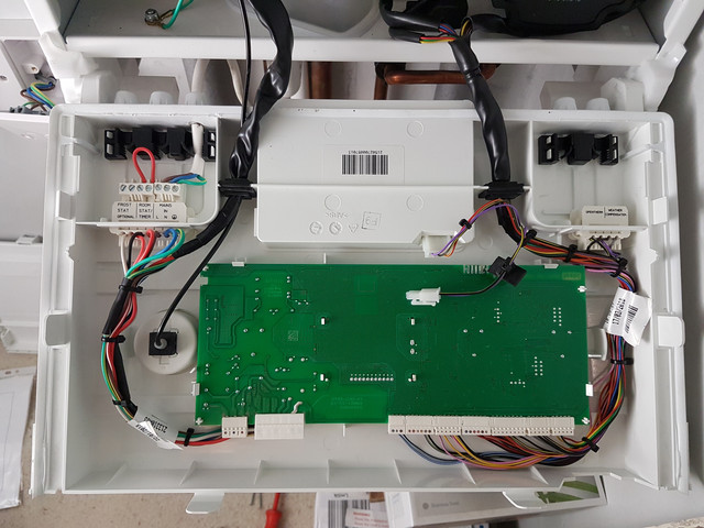

I'm seeking some advise/assistance with the installation of a Nest Learning Thermostat, 3rd Generation on a Zanussi Ultra+ Combi 35, which I'm sure many will be aware is a re-branded Ideal Logic+ Combi 35. OpenTherm has been selected as the preferred control protocol, simply because both pieces of hardware are compatible and the additional benefits OpenTherm should bring to the performance/efficiency.
I'm aware the connector currently fitted to the internal timer/programmer is to be removed and connected to the floating connector on the same harness, thus enabling the OpenTherm connections to be terminated. Annoyingly the four-pin connector for the OpenTherm connections hasn't been supplied (two for OpenTherm, two for the Weather Compensation module) but a couple of spade connectors suffice to connect to the appropriate pins. 48v DC is present on the two connectors.
Nest Heat Link is installed and wired, the Nest thermostat recognises OpenTherm connectivity (tested by disconnecting the OpenTherm wiring) but there is no call for heat registered on the boiler, despite the threshold being met on the thermostat.
Hope that reads clearly! Any thoughts?

I'm working alongside a Gas Safe engineer who has completed the boiler installation but who is unfamiliar with the installation of a Nest 3rd Generation thermostat. From a safety perspective any actions are performed alongside the Gas Safe engineer.
