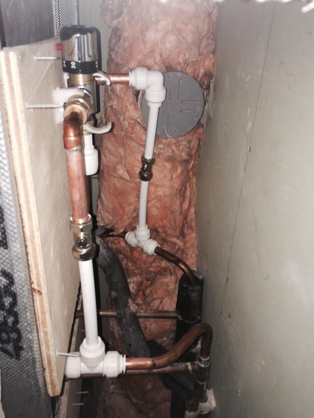

sorry to bring this back up im jst seen this
hope its not water mains :D
https://twitter.com/b9ukplumbing/status/573020242798100480/photo/1
and he's a forum sponser :D
:D
