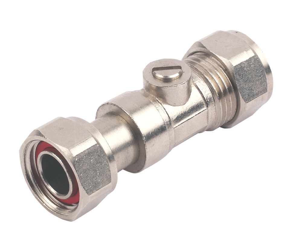

The isolation valve connected directly to our toilet fill valve has started to leak (I assume the washer has deteriorated). I'd like to get a like-for-like replacement so that I can just do a straight swap of the entire isolation valve without having to worry about resizing pipes, but my google skills have failed me (I'm a DIYer/Homeowner so not sure exactly what I should be searching for). Does anyone know where I can find this exact model? If not, can someone recommend a similar one I can use in its place?
Picture is from another user who posted a thread on this back in 2017, but I have this exact same valve.
its called a straight service valve. It will be 1/2" one end 15mm the other, basically what I link below but not the same one.
I doubt you'll find an exact copy though. You'll need to get a 15mm pipe slice and some jointing compound an adjustable spanner and grips.
Just change the washer 1/2 fibre / hep 20 1/2 washer
