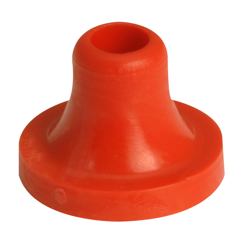

What’s misleading with that is, Screwfix state for high/mains pressure, but we know as plumbers that we can change the orifice for a low pressure type 😉
I did look at the high pressure valve in @ShaunCorbs post. B&Q have the same item (at 50% extra cost) but the B&Q online add says low pressure so I went to look at it. The packaging made no statement about the pressure so I got it out of the bag because I wanted to be certain.
It was high pressure with no low pressure jet. You can blow through the back with your lungs and tell which it is, also the jet diameter is noticeably different.
All the plastic float valves I saw have a white high pressure jet fitted and a red low pressure jet in the packaging. None of the brass valves have 2 jets. I looked pretty hard.
I got the low pressure from toolstation.
I can't post the link, you would see they do high and low pressure versions, not 1 version with 2 jets.
Will that fit the "Flo masta Brass Part 2 Float Valve 1/2" (3 5 8 F Y)"? (the original item you posted)
I haven't opened any valves up, if they all have the same jet inside then I wish I had known that 2 weeks ago.
I have a spare brass part 2 in the loft for the tank in the loft so I got it down and took it apart. Yes the brass valves contain the same white and red jets as the plastic valves so I could have changed the high pressure to low. I just didn't realise.
