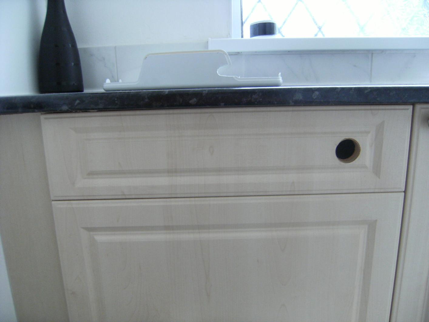

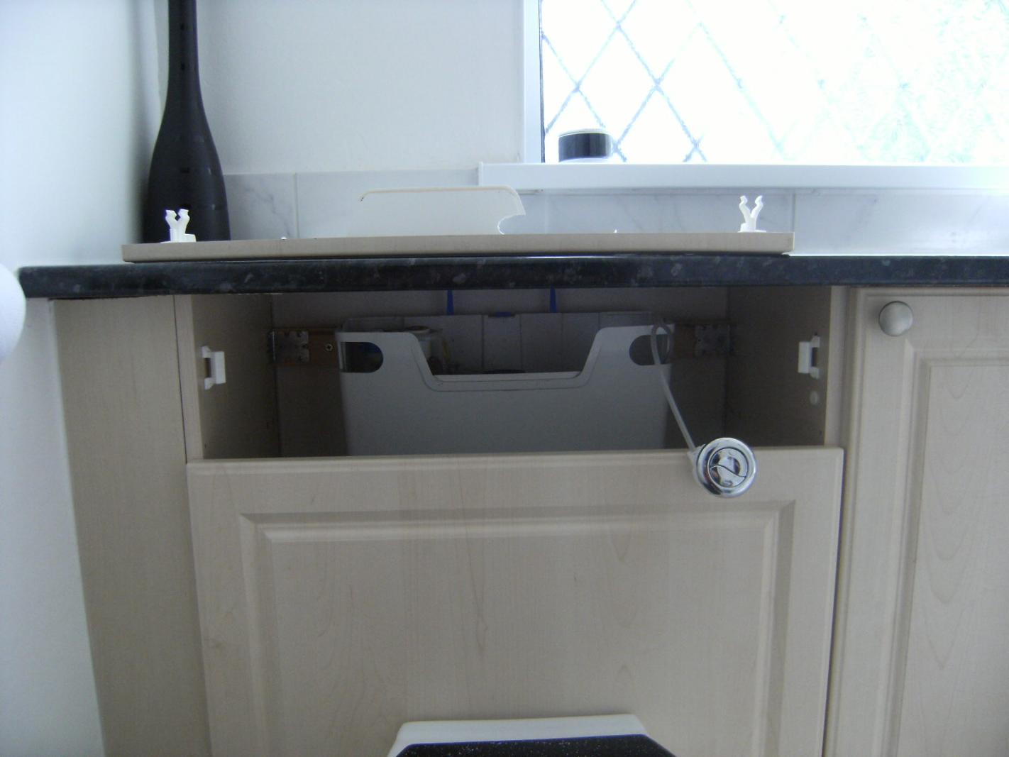

The access panel into my fitted unit is a 60cm x 16cm opening–see picture. I have become expert at dismantling the cistern and its components and extracting it out of the opening. Ideally I would like to be able to install the new cistern through the opening, but if I have to I will dissemble the whole front of the unit, including the pan, to fit a new cistern.
Another problem I must work with is that the panel where the push button is mounted has mouldings that limit the size of the push unit I can use. The flat centre section is only 38cm x 5.2cm. A shame because I would have liked to try one of the larger push panels. See picture.

i find that pneumatic flush buttons are harder to push than cable ones. i don't agree about not being able to fit another flush valve into your cistern get a good quality one . maybe old one was fitted at slight angle so fouling cable against side of cistern

Thanks for the response Steve. I will have a look and see whether I can get Fluidmaster valves to fit into the existing cistern. There was no fouling of the cable on the Torbeck - I tried a couple of different routes of it through the cistern to try to find a solution - even swapped the inlet valve onto the other side of the cistern to allow space to turn the outlet valve round so that the cable route was straighter - but no solution lasted more than a few months.
The cistern is mounted at the back of the housing unit, against the wall, so I had to use the 520mm cable option. As part of this change I will have to mount it further forward so that the Fluidmaster 350mm cable will reach.
