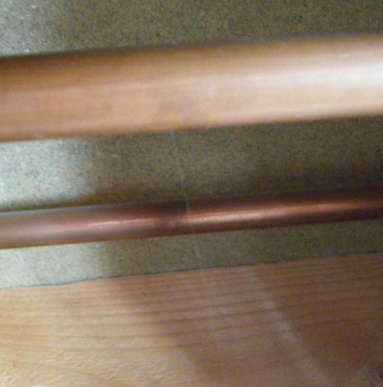

I did cut out a square around the wet patch in the ceiling though, and found this:
either side of the drip appears dry, and if I wipe it away it seems to form centrally, i.e. not rolling in from either direction. There is no visible break or whatnot, so what could be causing this? I thought pipes were fairly robust, and it is just the joints and fittings that can cause problems.
Is this a quick easy repair? Plumbers mait or something similar?
To make sure it is not running along pipe from either end, I would wrap some toilet tissue around the pipe both sides of the leak, about a foot away.
Then if it was coming along the pipe, one of the tissues would get wet and make it obvious.
That looks like its tracking from sumwere.If it was the pipe it would possibly be pouring out,trace the pipe to were it goes to and you may find the fault
I would say judging from the photo that it will be running along the pipe. If you have a cylinder fitted in a nearby cupboard have a look underneath where you might find the pump and valves. Check in there for leaks.
The toilet tissue suggestion will show you which side it's coming from.
I put the toilet tissue on and it stopped, but neither piece of paper was wet, its now stopped dripping altogether, but it does still feel slightly wet to touch.

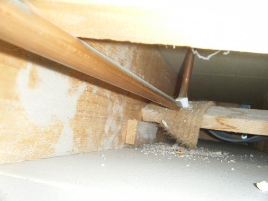

The above image shows the pipe going off to the left, best guess to the bath cold tap?? I'm thinking that gauze looking thing by the baton would absorb a drip from that end, and ultimately make the wet patch appear underneath that end of the ceiling.
This is it going to the right (highlighted the pipe in red), best guess is that this splits to the right to the bathroom sink, but to the left them pipes all go down to the gloworm, so does that mean its a hot water pipe?

If it has stopped with the tissue on the pipe, this suggests that it is tracking along the pipe and is being absorbed by the tissue.
As tissue is very absorbent, it could take quite a while (as it is a small leak) before the tissue becomes noticeably damp. I'd leave it on the pipe for a longer time and see what happens.
Okay I think I found it. I tried touching the pipe to see if it was still wet, and it felt a ever so slightly rough. I scratched it and now there is a miniscule spray, it looks like a strand of spider web its so small.
