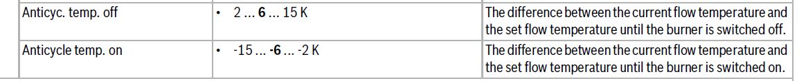

What is the boiler flow temperature required to flag this 2965 fault code?.
This, I believe, is a blocking code that trips the burner but when/if it resets. the burner will refire without any boiler reset?
If this fault code is up while in CH mode and there is a demand for HW, will the boiler still change over to DHW mode (combi) and refire the burner once this fault code clears.?
If the boiler is in DHW mode and this code is flagged does the burner just trip and then refire each time it clears?
