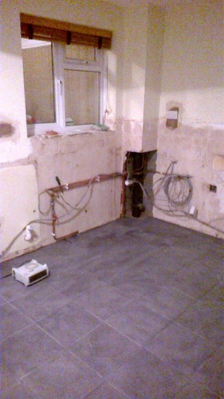

Are you sure you dont have any hot water pipes feeding your downstairs kitchen under a screed floor?
My hot water pipes for the kitchen run down the corner of the wall from upstairs. Have attached a picture to show what I mean.
I see. Is that your main stoptap coming out of the floor, pictures slightly blurry. And your hot water cylinder is upstairs?
Yes that is the main stoptap and the hot cylinder is upstairs in the airing cupboard. I have a small house with no central heating so the plumbing is limited to the back of the house only in the kitchen and bathroom and cold water tank and hot water tank are also in the back area of the house.
