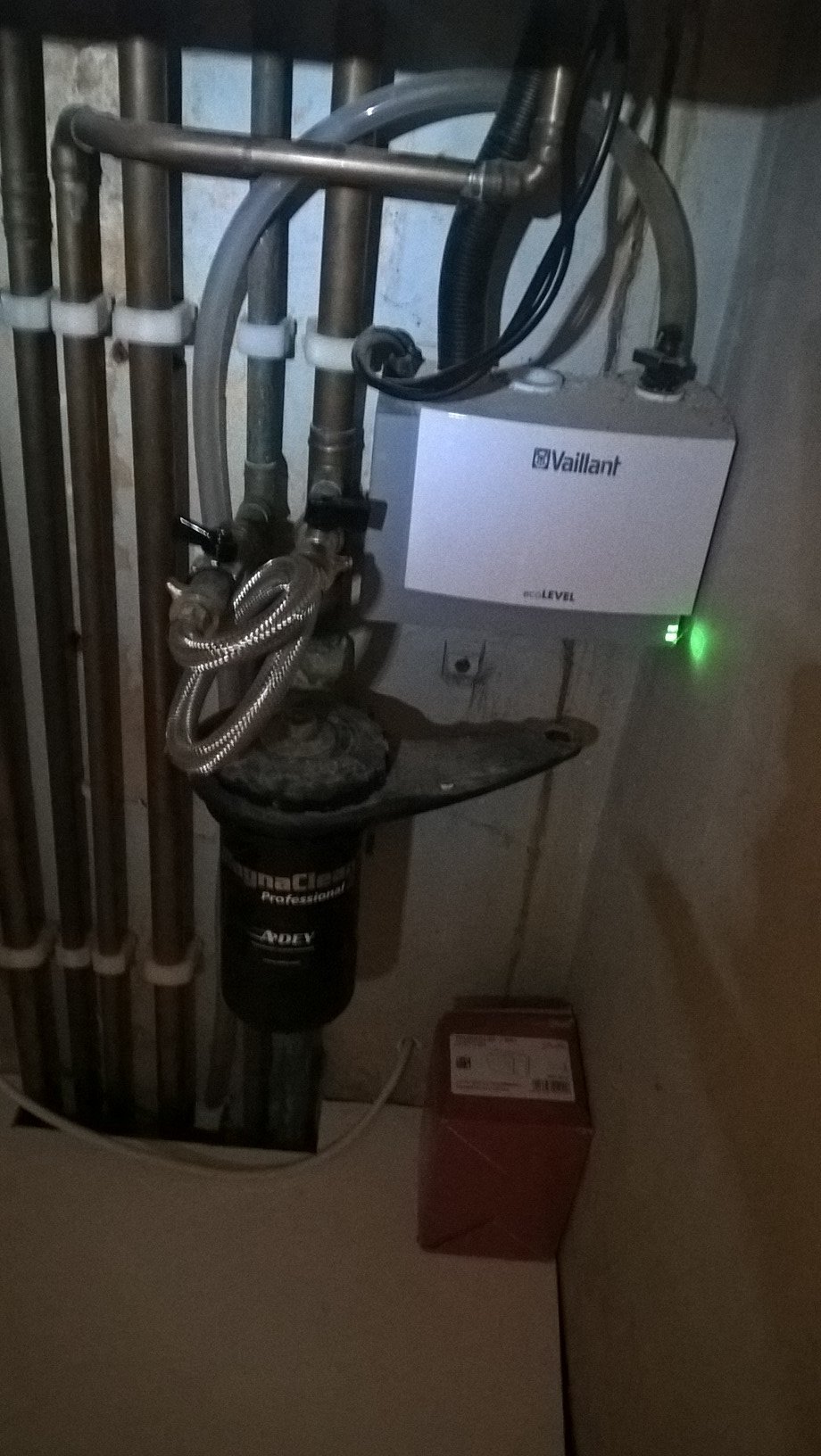

Does it have a condensate pump?

Yes, I think it does have a condensate pump. It has a square box below and to the side of the boiler with 2 clear ?plastic pipes attached to the boiler. Would that be it?
Sounds like a condensate punk. The prv will probably discharge into there as well
Here it is. Clear Pipe going into the white box and then one coming out and heading under the cupboard bottom
