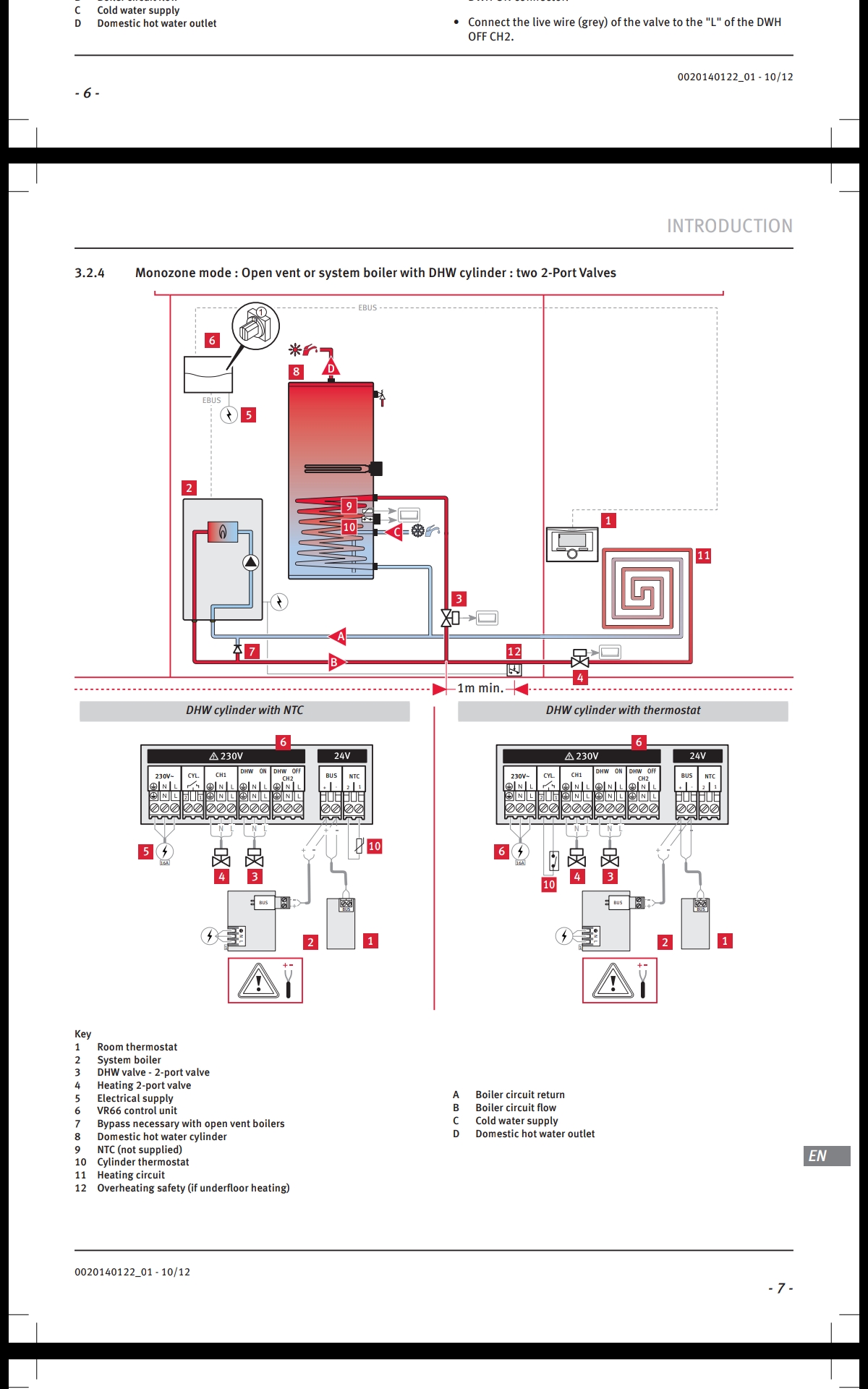

Thanks, by the way, for the wiring diagram. It's the same as the one in the installer's manual. Interestingly, our installer contacted the Vaillant installer support team to check a couple of things, and they said the eBus connections should be combined at the boiler, not at the VR66 as shown in the diagram.
