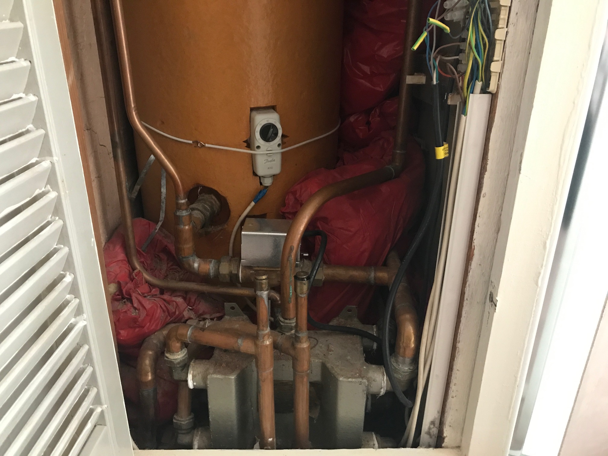

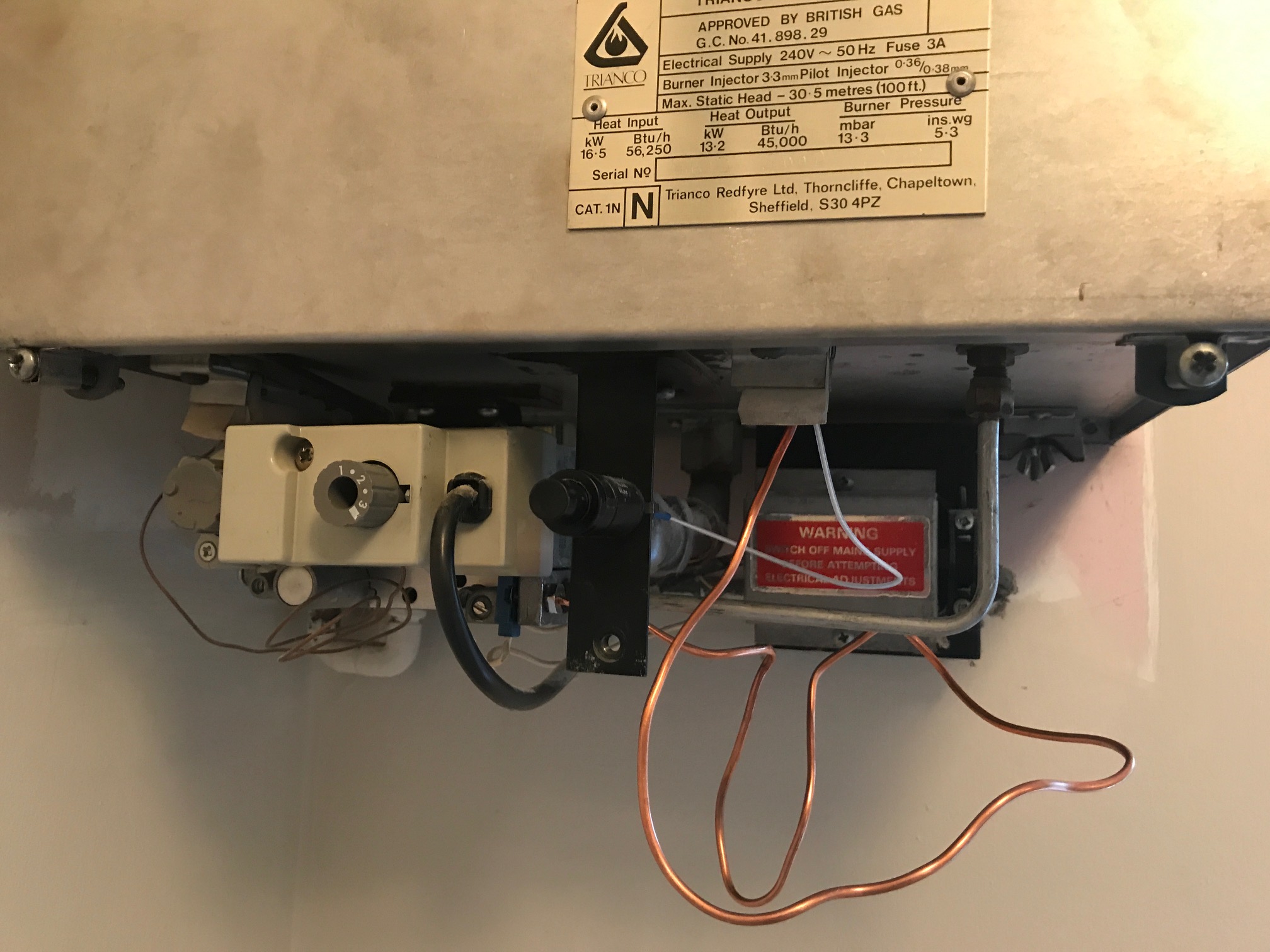

The boiler will fire no problem with just the hotwater on but once the heating is turned on the after around 10 minutes of
the radiators getting luke warm the boiler will click and the pilot will go out.
Ive replaced the thermocouple myself as this has gone before and i think its just wear and tear.
My very wide guess is some kind of overheat switch or just a build up of gunk in the system.
A general question if there might be anything i can try but im guessing most people in the know will be busy.
Couple of random pictures to explain -
I6L3XbCp
Pilot light shouldn't go out even if it overheats
Best option get a gas engineer in
Thanks, would a blockage or failing pump shut the boiler down (turn the pilot light off).
Ive tried over 15 local plumbers, 2 have visited and scratched their heads. The boiler was older than them...
No it won't
I don't like suggesting this but have you tried bg ?
Go for one that has been recommended to you. By friends or family. You have to be Gas Safe registered to work on a boiler
