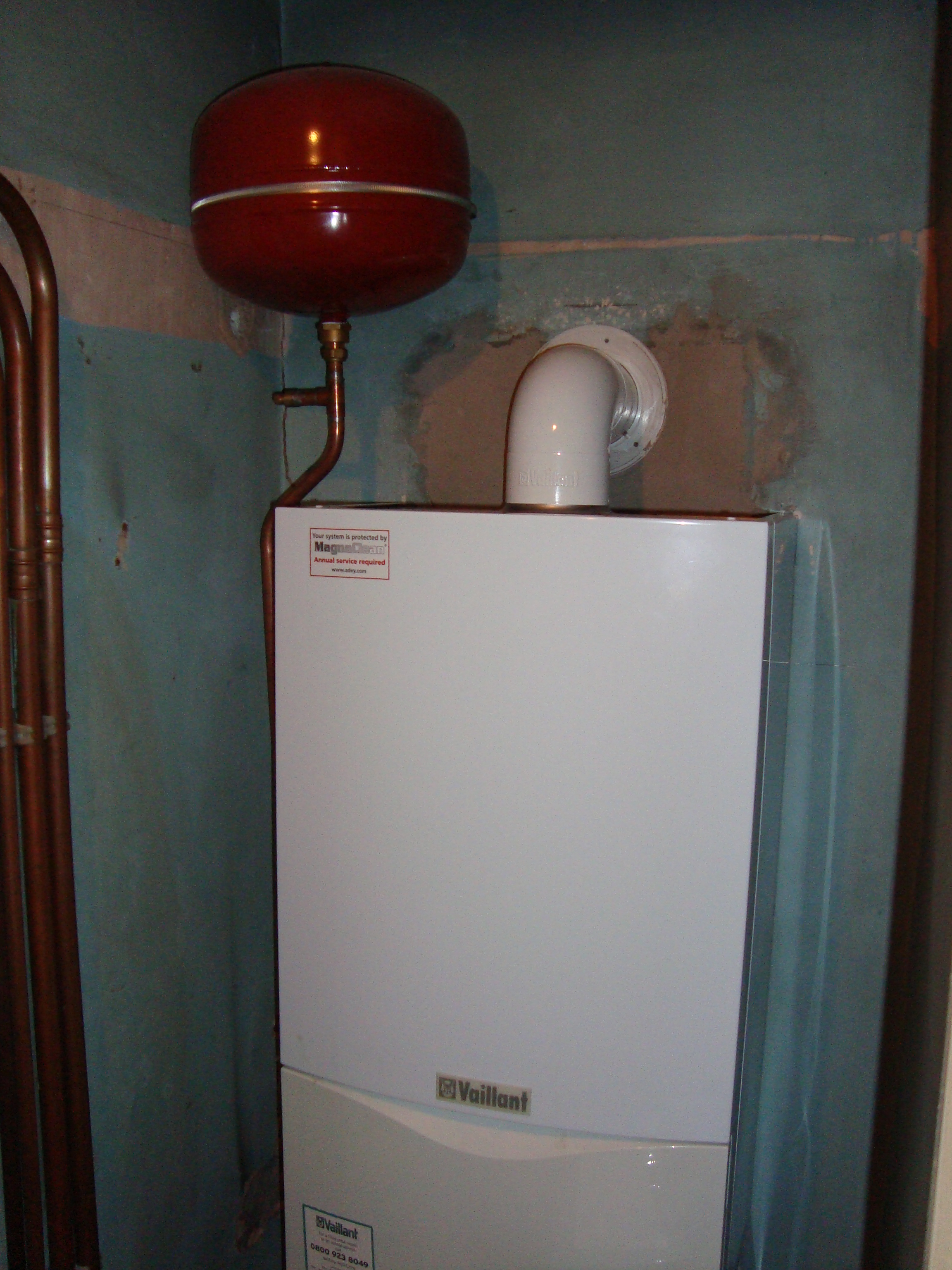

Any chance of some pictures of the boiler and pipework and gas meter please.
If enough room above or flue can be removed it can be done with boiler on the wall, or if there the space fit an external tank,

Do you know what an external exp vessel is? Big ugly things, but if you have room somewhere to have one fitted, then it'll save having to disturb your boiler. Yours will likely not have to be as big as this one, but it gives you an idea:
Dead easy to fit (if there's room...) so will be cheaper and it will sort your issue - tho' you also need that PRV replaced.

I've got the same boiler, and had the same problem. Wouldn't recommend taking a 15 year old boiler off the wall, especially as the flue may be damaged and you would need to pay for another.
If you can, fit an external vessel. 30 quid for the vessel from Toolstation, plus a bit of pipe and couple of fittings. Did mine myself. Before you go down this route, sometimes although the valve on old vessel is spurting water, the diaphragm can re-seat itself if you try inflating it with system drained. Not always though. You poss wouldn't need an espansion vessel as big as the one on my photo - I may have slightly over sized. Doesn't need to be above boiler either, could poss go underneath or other place - as long as it's plumbed into the heating return pipe near the boiler.

Doesn’t look like much space there for an external vessel. That’s why he has said what he did. I would change the boiler. It is almost a like for like swap if you go for another Vaillant. Might need to upgrade the gas pipe at the meter though if the meter is at the front of the house and the boiler is at the back. You may not get the correct pressures. (In my opinion)

The space under the boiler was enough to fit a microwave as this is how I hid the pipes, so at least 30cm high and then the depth of the microwave, so although the picture probably doesn't look like there's a lot of room, there was enough room for a microwave underneath the boiler - would this be enough room for an expansion vessel?
I'd have thought it pretty tight, tho' there's a chance (not sure of the size of vessel you need.)
What's under the microwave space - is there a kitchen base unit? If so, I'd have thought it could go in there.
Could you post a further-back picture to show what's around the boiler?
There's a worktop then underneath space for a washing machine, so I am afraid no kitchen unit to go under. I will aim to get a photo again tonight, I may not be able to get back to the house until tomorrow though, whichever way I will get one and post it.
