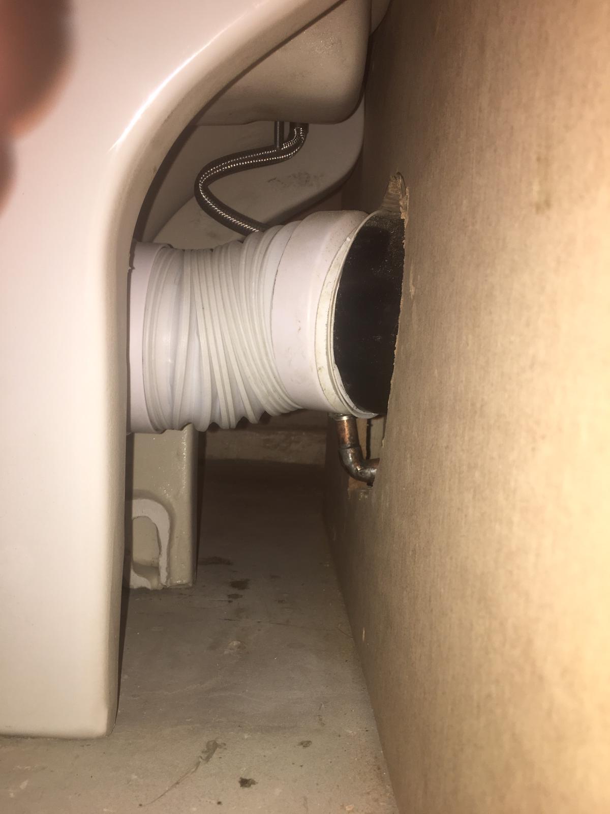

We've just had a new toilet installed and the new toilet's waste pipe is lower than the cast iron soil pipe. My installer has used a flexi pipe to connect the toilet waste upwards to the soil pipe. Am I right to be concerned about the upwards connection, and the use of a flexi pipe? The cast iron soil pipe is about 1 inch higher than the toilet waste pipe. What might a good solution be?

Need to raise the toilet
That flexi isn’t acceptable either look at that sharp bend
Get the installer back

Thanks for your quick reply. When you say the flexi isn't acceptable, is that the silver clean water pipe?
And by raising the toilet would that mean putting it on a plinth?
Also, any thoughts on the use of the flexible pan connector? I've read a few things about them not being very good.
Yes too sharp of a bend (looks kinked) they tend to split when it’s done like that
Yes or could you raise the floor ?
There ok not the best tho but not installed like that
