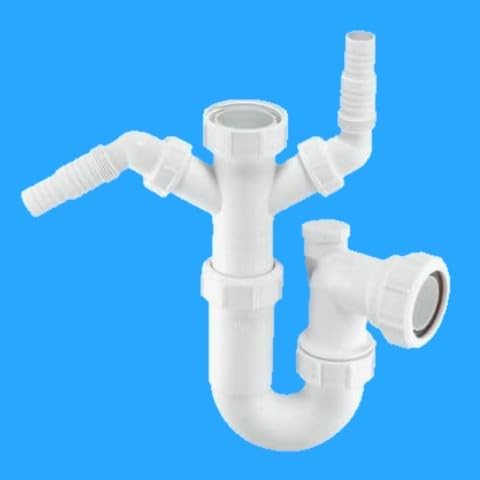

The dish and washing machine pipes should rise as high up as they can ideally just under the top of the sink and then back down if they need too
Also double check you haven’t a blockage in the pipework downstream of the trap / check the trap
any thing that comes out of that rh pipe will go down that pipe.
can you rejig it so it flows into the down pipe below where the dish washer goes in.
Put an appliance trap with two appliance spigots on one sink, and a plain p trap on the other sink. Then tee them together into the existing pipework, it’ll take up a bit more cupboard space but give you fewer problems. (I have my two sinks each with a p trap and separate pies through the wall to a gully, it’s the most trouble free set up I’ve ever had- so if it’s simple to do there, copy me!)
