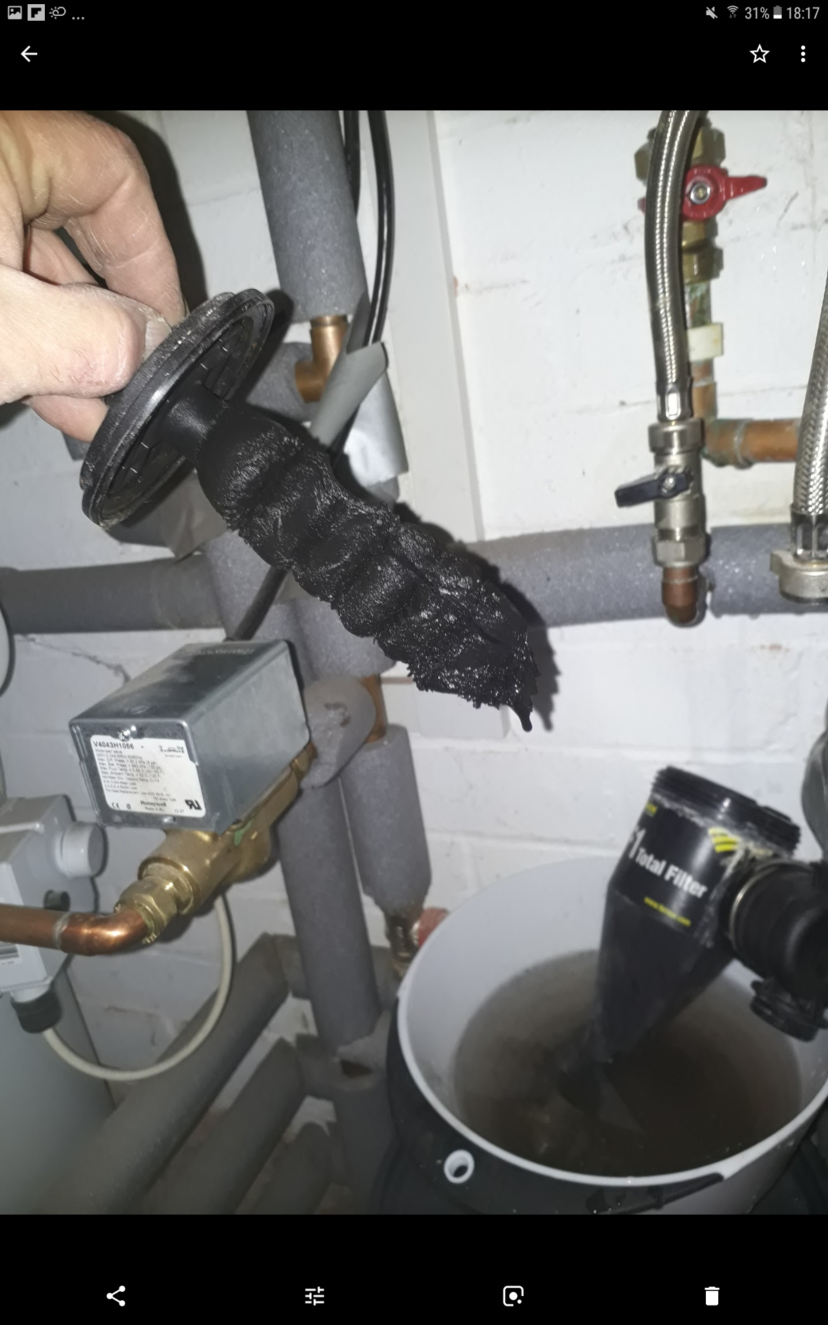

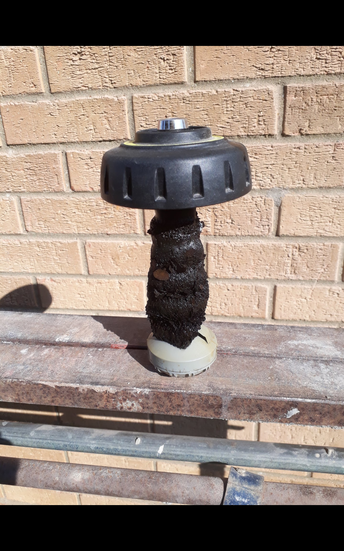

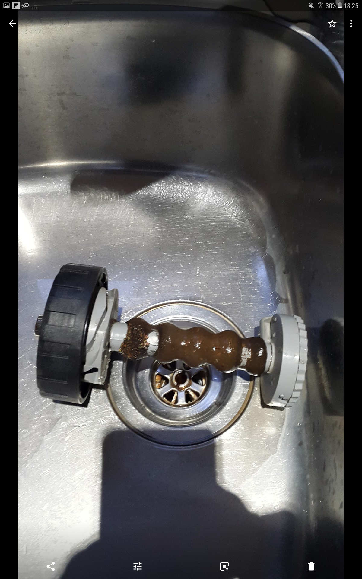

oh dear thats very bad, you really let that go and at that point the magnaclean will be useless - nice pics I will put it in my rogues gallery.
send it to Adey (magnaclean) they will love it. So isolate boiler and flush it. Then isolate system and flush it for a long time backwards and fwds. At this level I expect the rads are badly affected so you will need to go along the bottom with a magnet - use the magnaclean one to break up the sludge compacted. You have black sludge and some brown - brown is more oxidised which means there is leak, black is more anerobic and is a reaction between various metals in the system
My filter wasn't anything like that dirty.... just a film of black over the centre piece.
