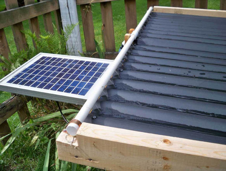

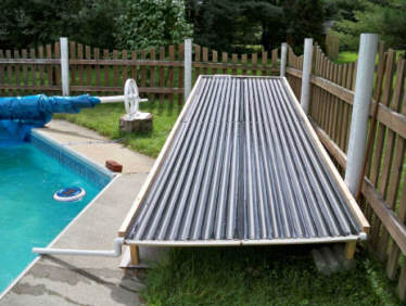

Make a DIY one for constant direct heating;
suck water up with solar panel for the pump to the top and back into the pool
^^^^^^^^ Ingenious, does it work OK?
